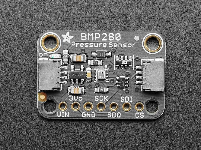

You can use static pressure to measure the z component.

If height is your main goal, why not use a pressure sensor? You should be able to measure the displacement to 200m very accurately this way.
