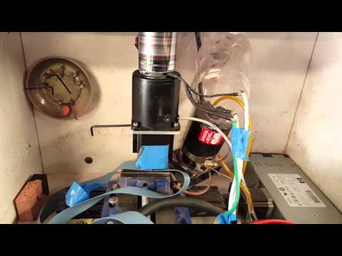

Hi, before I start pouring in the time to do a project, I like to know if it's possible.
I'm trying to use MACH3 cnc to control my rc speed control. The pwm out is easy enough, but I basically want to replace the knob with a pwm input signal.
Not sure if I understand it correctly.

Exactly. I know they are different pwm. I want to use the arduino as a translator to convert the one pwm into the other one.
The knob im refrencing is in the examples library. I want to use pwm imput to control the hobby esc/servo instead of a knob.
And yes I need hobby servo pwm for my spinndle. This is where im at so far

I do know it outputs standard pwm. That's my issue in regards to controlling my hobby speed control (needs servo pwm)
Here is the best info I've found.
