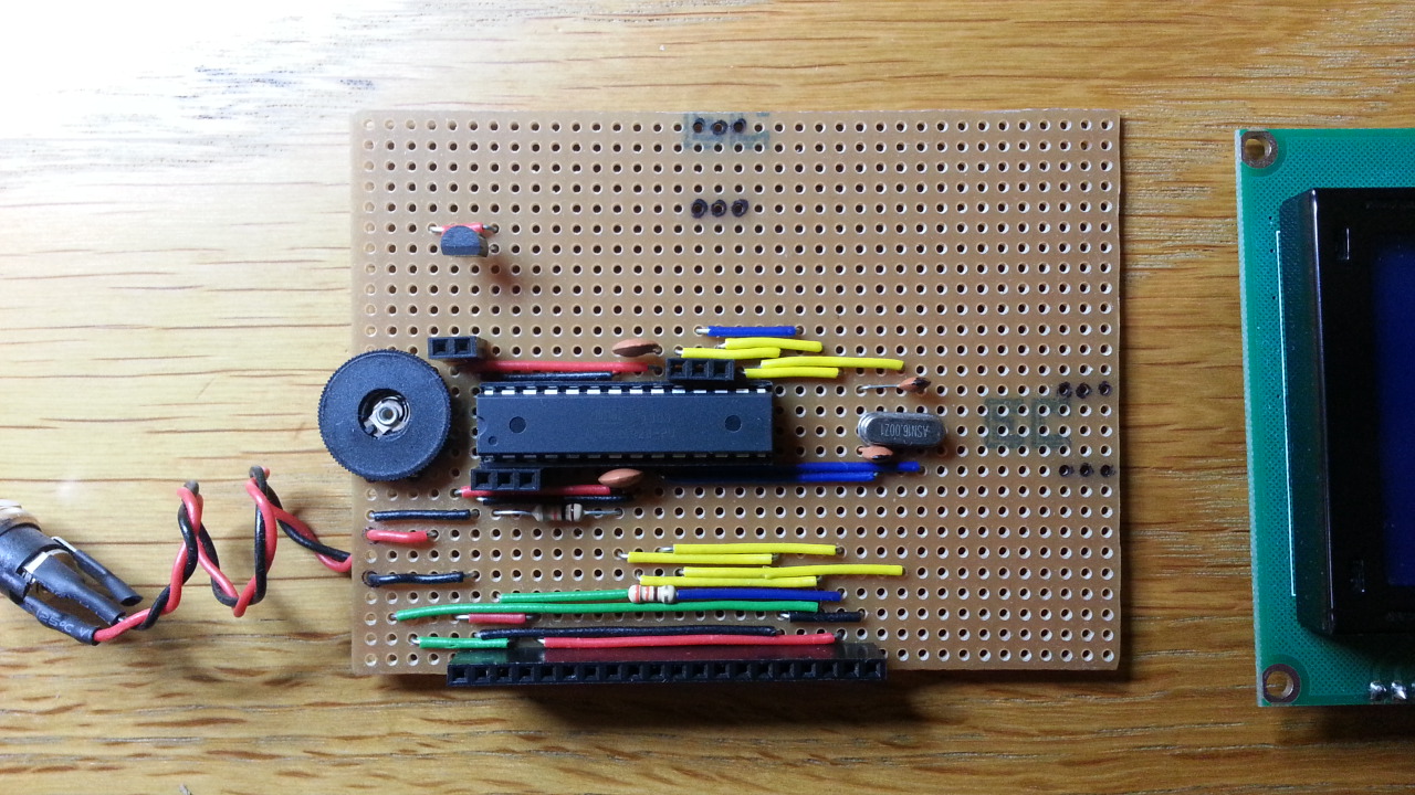

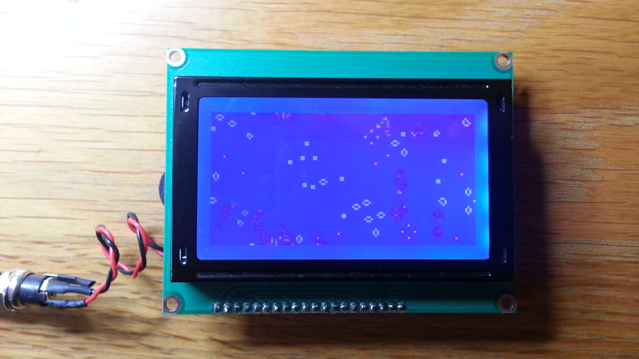

This is a bit of an "unfinished work", but I though I should write it up before I forget the details!
Conway's game of life, in case you don't know, is a simulation of colonies of cells living on a rectangular grid. Each position on the grid can contain a cell or be empty, and over each generation, a cell can continue to live, or die, or a new cell can be born, depending on a few very simple rules to do with how many cells are living in the immediate neighbourhood.
I originally developed the code on a Nano 3, then transferred it to a stand-alone ATmega328, using the Nano running ArduinoISP to program it. It should be easy to get running on any Arduino with a similar display connected.
Video: [Conway's Game of Life Arduino (digitalWriteFast) - YouTube](http://www.youtube.com/watch?v=_mRWPWDnON4)
 ![20140208_150015.jpg](https://europe1.discourse-cdn.com/arduino/original/4X/3/2/d/32db5ae8487da73fe49014ae05ecaa34ea9e6764.jpeg)
 ![20140208_150155.jpg](https://europe1.discourse-cdn.com/arduino/original/4X/1/8/2/182a610c841edc71894bdd2d6eed70dae2e26b2c.jpeg)
