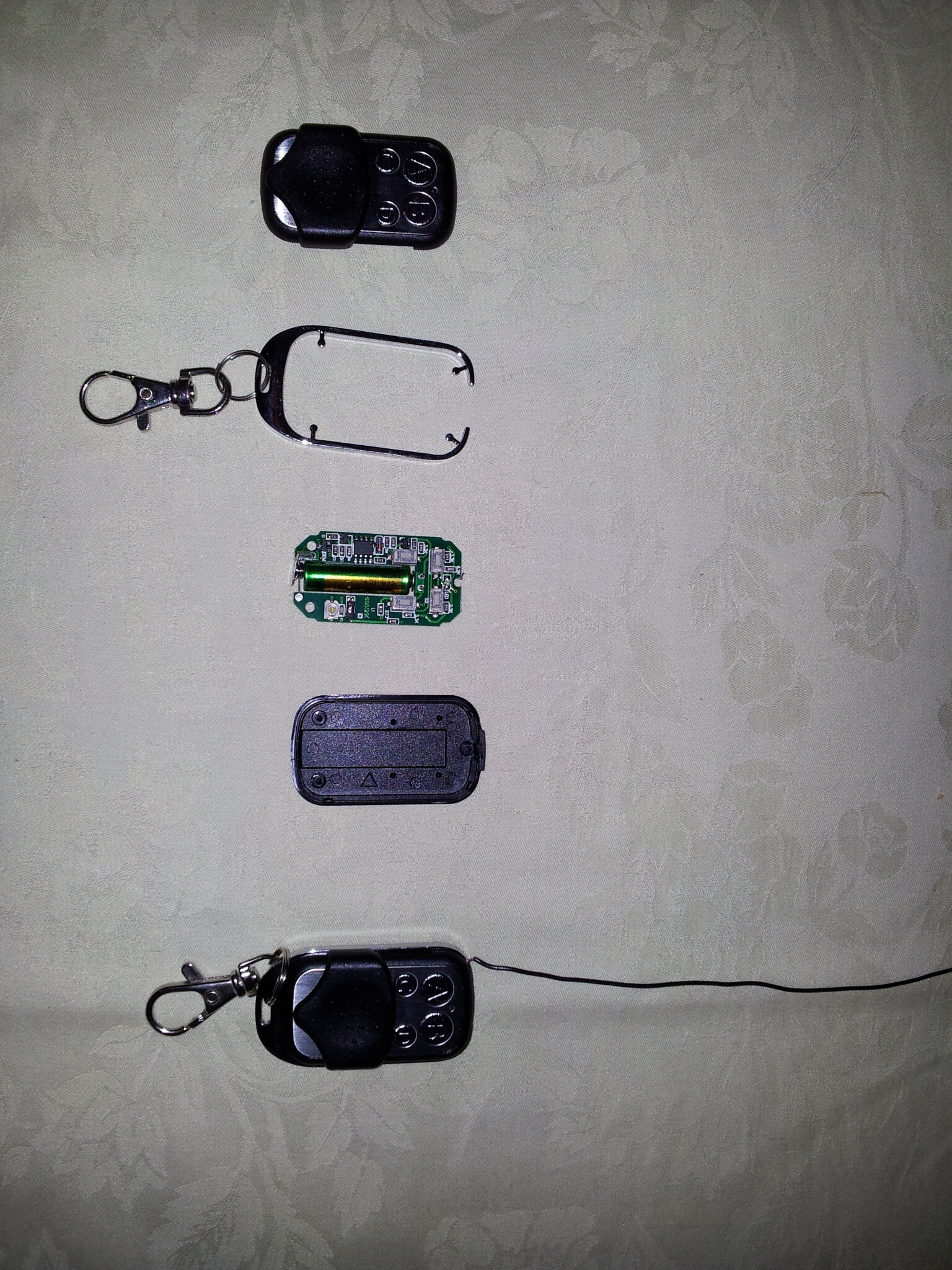

But I have discovered a plus thing. These remote controllers dont have an antenna, just a metal casing which is functioning as an antenna. (it has no contact) But if I put together it with a wire the range increases about to 5-10m.
So maybe if I apply somehow an external antenna, could it extend the range?
Here's a picture of it.
I can't seen the antenna or antenna connection on the circuit board. Is it on the other side ?
About 5 to 10 meters is normal for very bad quality transmitters. You can try with an antenna.
The wire what I'm using is not connected to the circuit board. Just to the metal case. (2. item on the picture from left.) And the metal casing is also not connected to the board.
I tried to connect the wire to the board, but I couldn't find any point where it worked.
