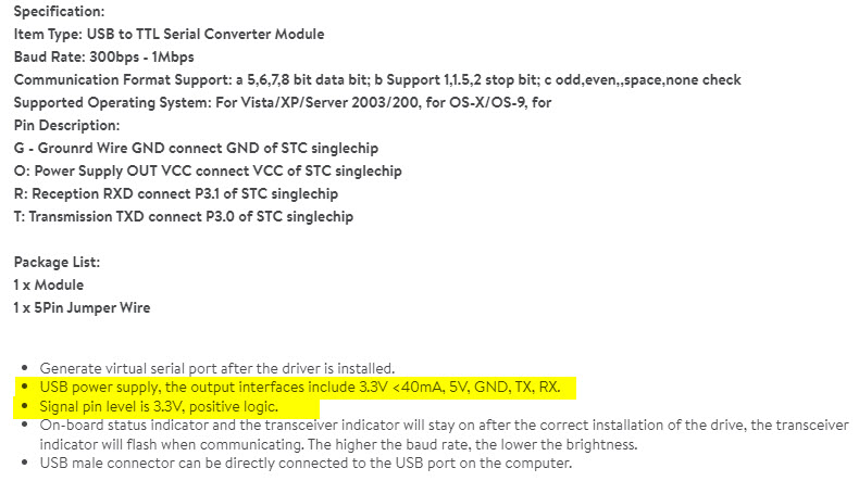

So something like this guy is what you are suggesting:
https://www.walmart.com/ip/USB-To-TTL-Serial-Module-Serial-Converter-Module-300bps-1Mbps-Baud-Rate-Serial-Adapter-For-DIY-Teaching/1916205152?wmlspartner=wlpa&selectedSellerId=101296366
Looks like it will work, however, they do not mention what the USB to Serial chip number is.
It says Supported Operating System: For Vista/XP/Server 2003/200, for OS-X/OS-9, for
  • You will of course need to install the Windows driver for the module.

From the IC package of the chip shown in the image, and from the information on other listings for products with the same design, it looks like it is a Silicon Labs CP2102.
The odd lack of labeling on the chip that is for some reason common practice in this type of Chinese product raises some doubt about the provenance of the chip. You can sometimes see by looking carefully at the product photo in this type of listing that there was labeling but the seller photoshopped it off the chip. My experience with buying things from the sketchy Chinese sellers on eBay and Aliexpress (I never used Walmart marketplace to make such purchases, but the same class of sellers use all the major marketplaces) is that when the hardware arrives, the label is there on the chip (though of course that is no guarantee of authenticity and quality control. But I have seen pictures shared by customers of some boards where the physical chip actually didn't have the labeling either, and without the look of it being sanded off as is common practice even from reputable manufacturers trying to prevent reverse engineering of their hardware (obviously not applicable here). Maybe those chips failed a QA check done before they reached the labeling stage of the manufacturing process? Or maybe the manufacturer offers legitimate unlabeled chips at a small discount due to the cost savings of skipping the labeling process?

Sorry, I didn't do a good job of communicating in my previous reply. I was referring to the product you linked to on the Walmart marketplace, not the one sold by analoglamb. I was talking about this module:
Ah no worries! I am just misguided and not sure where to go so I apologize. Thank you for the reply thoough, I didn't know walmart marketplace could be a little sketchy
