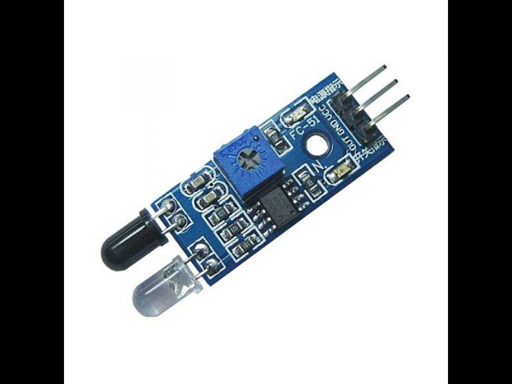

Do you mean one of these?
For 20 sensors along a line at around 10M, it may not be good to route all those sensors with signals line back to MCU, those wire will take much place.
Instead, it will be good to implement by a common bus to save space.
Thanks for your sharing on IR temperature sensor. I guess instead of IR temperature type, i can make use of IR reflection type (i.e. transmit & receive as a pair in a module) like the one shown by jim-p.
ok but is the project for the Arduino to know the position of the person or is the project to just turn on a led when the person is in front of the sensor? If just to turn on the LED, there is no need for an Arduino, just add a circuit to turn on the LED while a person is sensed by the IR reflection.
