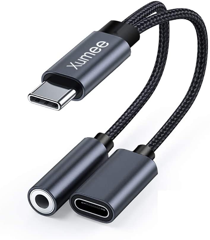

Could it be possible to use a usb-c aux adapter for my UNO with a C type port?
I'll keep it plain and simple. Im a beginner to arduino, and want to know if i could use something like this:
https://www.amazon.com/dp/B08LNXVBYN/ref=redir_mobile_desktop_encoding=UTF8&aaxitk=8a2d38d7129499db81c0828b36dfad95&hsa_cr_id=7626032290901&pd_rd_plhdr=t&pd_rd_r=0c39e454-abae-491e-ab79-8e59c4c85fb9&pd_rd_w=48UZ4&pd_rd_wg=jx4u4&ref_=sbx_be_s_sparkle_mcd_asin_0_img
with my arduino? It seems unplausable, but i decided that it was worth a try. Hard to find anything on google, so i signed up for this to ask.

You linked a USB C type cable. There are Arduino boards that use USB C but older types are more common.

Yes it is totally not a plausible thing to expect to work. The Arduino only has a USB type 1 connector and that looks like a serial port to the host computer. There is no Audio capability with the type of USB connection the Arduino has.

Its a c-type plug, so i just had to check if i could possibly use it to play audio for say when a button is pressed. I can probably just buy something on amazon that would work the exact same

One is that Arduinos are only "devices", not USB "hosts". This cable expects to plug into a USB "OTG" port on a phone which functions as a host and I know of no Arduino which does. There are "host shields" with limited ability to act as a host, but not OTG.
Second is that your "Arduino" is probably a basic UNO or (preferably) Nano or similar. While there is an "Audio" forum here which I do not choose to look at, serious ("hi-fi") audio applications are way beyond the capability of most Arduinos without extensive support modules. Mobile phones OTOH have serious computing power.
