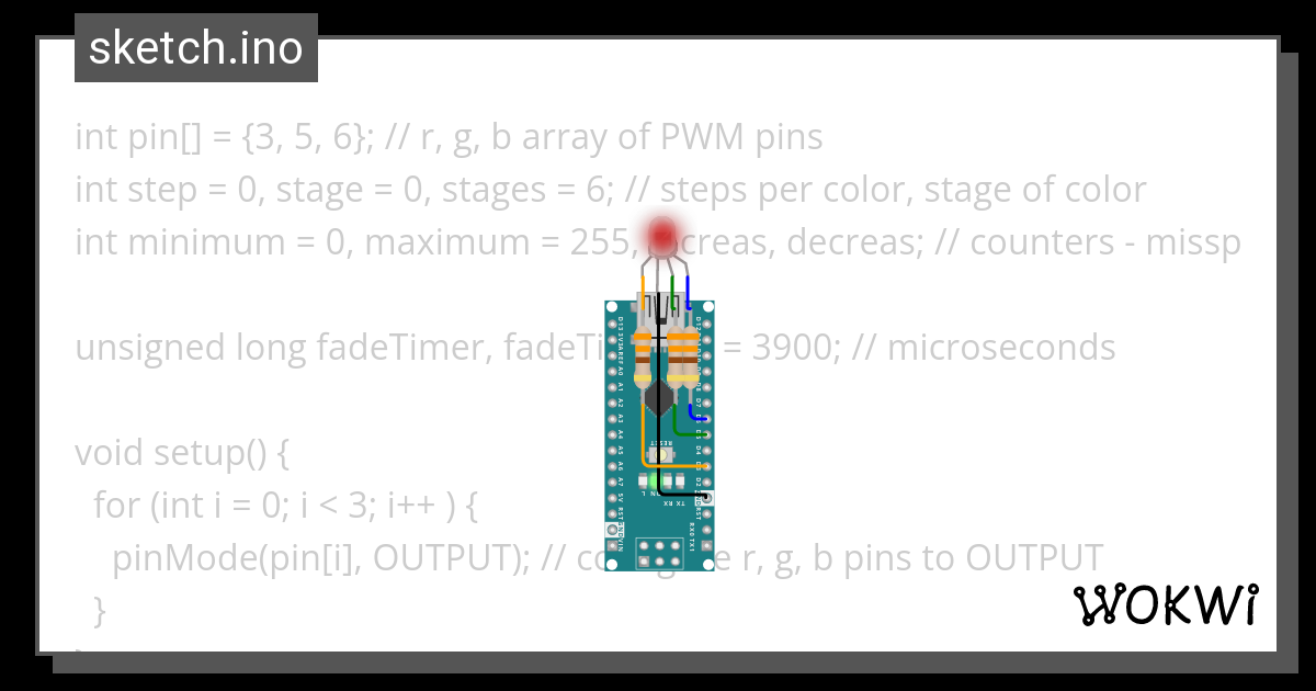

... and a fancy example to slew through the colors using millis() / micros() as a timer...
