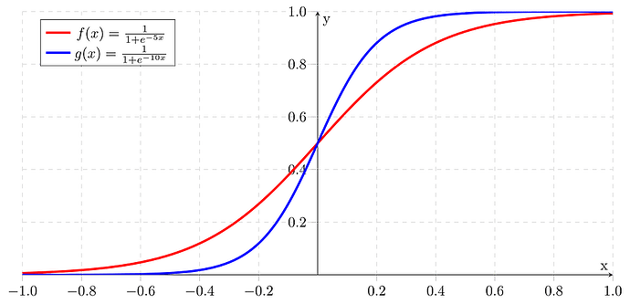

if you imagine the point where the red and blue line cross as zero, that's what i think the game is applying, probably more like the red though.
im sorry if that answer seems off i am not to familiar with actuall math side of these graphs or the curves them selfs and only know them as is relevant to analog stick aim, i am thinking of a -1 to 1 x and y grid where the point where those two lines meet would be 0

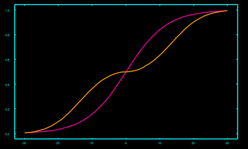

maybe just square the x input (orange) compared to the red curve in post #3

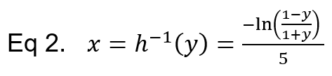

Trying to interpret your words (actually trying to mind read) ... I'm guessing you want the first plots you presented to pass through the origin and run from -1 to -1 on both axes. So the equation you presented needs to be scaled and shifted:
That plots as:
A little High School Algebra produces the inverse function (what I think you want):
That plots as:
Note that Eq 1 only approaches +/-1 asymptotically. So you'll want to clip the input (y) value to Eq 2 so that:

FWIW the plot is exactly a line, so you got it right as far as I can tell
y\ =\ -\ \frac{\left(\ln\ \left(\frac{\left(1\ -\ \left(2/(1+e^{\left(-5x\right)})-1\right)\right)}{\left(1\ +\ \left(2/(1+e^{\left(-5x\right)})-1\right)\right)}\right)\right)}{5}
Haha, that's cut from Desmos | Graphing Calculator where I put x into the forward function H and that result of that into the inverse function H^(-1) that you showed in pictures.
