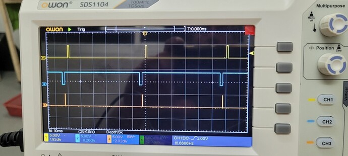

To try and break it down. The process will be as follows:
  1. Pulse from VR sensor at flywheel
  2. Interrupt on D2.
  3. Calculate rpm based on time between pulses on D2.
  4. Start Timer2. Ticks based on rpm and ignition advance required.
  5. Timer 2 interrupts and starts Timer1.
  6. OCR1A interrupts and turns on DC to DC converter.
  7. 2ms later OCR1B interrupts and turns off the DC to DC converter and turns on a thyristor.
  8. Capacitor discharges and fires spark plug.
  9. Timer1 interrupts on Top and switches off thyristor around 10 ticks (haven't decided yet) after OCR1B interrupt.
  10. Wait for next interrupt on D2.
The D2 interrupt may come before Timer1 has reached TOP, hence why I'm starting Timer2. Then Timer1 should have reached TOP before Timer2 interrupts.
The process for a CDI is quite simple, but choosing the right components and getting the timing right has been a little bit of a challenge.
With simple switching code and no input pulse I've ha it running for hours at a simulated 5,000rpm. Nothing got hot or exploded.
Using a pulse signal proved a little trickier due to electrical noise and interference, but solved this with some bypass caps and a resistor here and there.
And I'm sure that if/when I've actually got it in a bike then there will be all other ort of noise issues which I'll have to deal with.
Initially I'll just use a fixed ignition advance to test it. And try different advance values to check that the firing of the thyristor changes as it should. Then I'll try to implement variable timing based on rpm. I've built a simple excel table which uses interpolation between two points and this works fine in excel, so I'll try to include that somewhere.
This may work OK at relatively low rpm where there's plenty of time to do the calculations but I fear that the Arduino may struggle at high rpm. But we shall see.
As I said, also plan to try this with an ESP32, which with it's 64bit timers should be a little easier to do (maybe)... The idea is the same pretty much with an external interrupt stating the process and then using some or all of the available 64 bit timers to start each section of the process. Possible in theory. The great thing with the ESP32 is that I can split calculations between cores, with semaphore protection of the variables, to keep things running at light speed. I doubt that the ESP32 will break a sweat running the code. My data logger does way more work, including updating the TFT display and is pretty stable thanks to using both cores.

@cattledog @GoForSmoke
Just a quickie.
Managed to gel the previous CDI code with the overflow code and it works with a couple of glitches now and again:

And a couple of scope traces for yor enjoyment:
1000rpm:
13000rpm
Ch1 (yellow) is the input pulse to interrupt on pin 2
Ch2 (blue) is to switch the transistor from pin 10
Ch3 (orange) is to switch the SCR on and off.
I've been on it all afternoon and I'm quite happy with that.
Matt
Not sure that I'm doing it the best way in thee loop() but it seems to work.
Accuracy is a little off but I suspect that down to the time taken in the interrupts and probably got some errors in my maths. :slight_smile:
Comments?
Matt​
