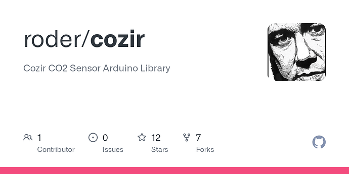

I have used this code before and my sensors have worked and I have gotten readings back. The code is from
and it worked until I tried to get readings with GASLAB. Then after that, all my sensors read 0, until I try them back with GASLAB, and they do give me readings over there, but not with Arduino anymore. Has anyone experience such a thing before.
