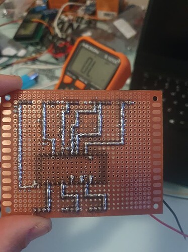

I just spent hours creating this:
I have to make 4 more urgently and then (brace yourself) 24 more semi-urgently.
I thought I would get away with just doing it by hand, but I didn't realise how slow it is (especially for me, not particularly skilled at this).
I need an easier way out for my own mental sanity.
Can I buy some copper boards and maybe use some acid to dissolve whatever parts I didn't draw on? Or is there a better way of doing this I don't know about?
Any ideas will be very welcome!
Merc.

Design a board with Eagle, KiKadd and have some made. And have it populated or do it yourself.
Are you bridging the pads with solder instead of using wire?
I am... it seemed like a more straightforward way of doing it, especially since I had so many bends... bad idea eh?

It looks like you are only connecting one pin from each connector to the Nano? Much easier to get some 28 or 30 gauge wire and just solder each end. By the time you are done, you will be much more skilled :slight_smile:
This is how I would go about it. Been about 13 years but I had boards made. Just send them a Gerber file and as suggested you can have the boards populated if you choose. My turn around time was under a week and having it all done was really inexpensive.

Here is an example of using 30 gauge solid wire.
Do the next 5 by hand. Take the time after that to learn Eagle/KiCAD as suggested and make a PC board for the next 12. jlcpcb.com is very cheap and ships quickly.

This will be much easier on Stripboard.
The strips provide your vertical tracks, no need to make them yourself. Use wires for the horizontal. Terminate the strips where needed by removing the copper with a drill bit.

What is puzzling me is what on earth the boards do with, apparently, only 1 wire from each 4 way connector to the Nano. No circuit I can think of would work like that.
Make it like sewing: put the wire on top of the board, through the holes next to the pins. Make a diagram, prepare all boards, turn them around and solder the wires. Works perfectly with wire-wrap-wires 'ause the insulation melts and shrinks when in contact with a soldering iron.
That's only half the story. The other half is on the other side of the board:
This is how it fits in the box:
Merc.
Please don't make rat's nest like this. Use a dedicadet solder point or screw terminals so you cannot rip the wires while soldeing / handling. Or solder the stepdown directly onto the board using 2 posts.
