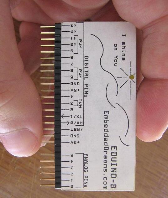

This is my DIY "arduino", although is little more than a breaduino on a PCB
EDuino
I designed the PCB to be very very easy to do at home.

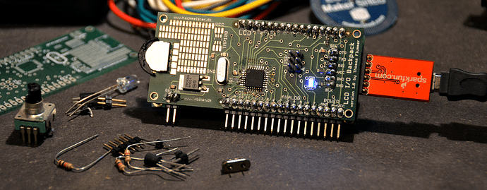

That is cool! - It reminds me a bit of our local hackerspace's own arduino variant, the LCD IO Backpack:
// Per.
Hey, good work on that LCD IO Backpack board! So you guys are making workshops around it?
I actually have also an (unpublished) design/prototype for an LCD backpack Arduino-platform based, the main difference being that it was designed to be standalone and provide efficient power to "expansion boards"; it's a bit bigger than the LCD to support a 1A switched buck converter, 3 buttons on the side, a power jack and a simple RS-232 converter - in a single sided PCB you can do at home (4 or 5 jumpers on the component side). I have some ambitious fw and PC sw plans for it, so it's still in the lab, right now being used as an I2C console to debug another project I'm working on!
We did a single workshop around it. Usually if we make something small, we build one of these boards and use them. The small proto-area for SMD components is cool too.
We had a bunch of the PCB's fabricated, and when they are all used up, we'll make some changes on it, and maybe selling them outside Labitat - who knows.
// Per.
Good, that's good, go for it guys.
So that's an SMD prototyping area... good idea!
