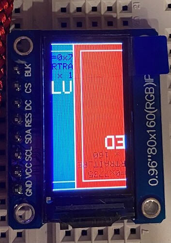

Hi, new here. I have used this display before (Green Tab), no problem. I just purchased 8 displays from AliExpress LINK which all crop the display, leaving maybe 26 pixels blank at one end. What does display is blurry as well. These displays have a Blue Tab FWIW.
I have played with the 7735S inits, different color tabs, different speeds etc but nothing works. Does anyone have some advice? I am about ready to open a dispute and send the displays back.

I tried the sketch (I had to add fonts and SPI pin spec to the user_setup...)
It made no difference to the offset (see pic below) and colors were wrong.
Selecting ST7735_REDTAB160x80 cured the color problems but no joy on offsets.
I am also attaching a pic of both sides of my display... I can do higher res if you wish.

I would be much happier if you photo showed the output from my sketch.
Does this show ST7735_REDTAB160x80 or ST7735_GREENTAB160x80 ?
The GRAY looks like CYAN or AZURE to me. Might be your camera.
The geometry is wrong.
The outer rectangle does not show any right edge.
The inner rectangle is too wide. You don't see the right edge.
I suspect the ribbon is covered by some black tape.

Sorry I wasn't clear... but I don't know what your output SHOULD look like...
ST7735_GREENTAB160x80 distorts the colors so I can't read the text
ST7735_REDTAB160x80 shows color that matches the white text in every case
The GRAY example is GRAY in-person and other colors are correct too.
Rectangles look good to me EXCEPT for the blank (upper?) portion of the display obviously.
I understand the offset in TFT_eSPI for starting row/column but is there an adjustment for the
ending? To my inexperienced eye it looks like the display simply truncates rows/cols above 120.
Please just post a photo of the ST7735_GREENTAB160x80
Please let me diagnose colour, geometry etc.
If you look at my code you will see that every screen has an outer white rectangle. And an inner rectangle. I cope with many different geometries so it is not so easy for you to read.
It should be a 80x160 outer, 64x144 inner rectangle for Portrait.
It should be a 160x80 outer, 144x64 inner rectangle for Landscape.
Yes, you have a big offset on your Panel. Which is why I would like to see

In a previous test with GREENTAB I couldn't read the text, perhaps I had fonts messed up?
However, below are photos of my panel using ST7735_GREENTAB160x80
I would say:
BLUE looks yellow
GREEN looks magenta
GRAY look gray
RED looks cyan
The colours are cured by adding this to the ST7735_GREENTAB160x80 setup.
#define TFT_INVERSION_ON
But the geometry is skewed. The LANDSCAPE (GREEN) shows some smeary scan lines at the top. So your Panel is physically 160x80. But we just need to tell the ST7735 registers.
Have you ever seen any lit pixels in that "top smeary area" ?
It is a "scan feature" not a pixel-mapping problem.

I see the backlight bleed behind the unused area of the display but never anything else.
I asked the seller and they sent me some 8051 c code which means nothing to me.
Perhaps it does to you?

TFT_INVERSION_ON has NO effect on my display. Same as the latest photos I sent
TFT_INVERSION_ON works on my Panel (and any others)
It might be simplest to just pop a display in the mail.
Alternatively I convert the 8051 code for you.
Personally, I don't believe that 8051 code. I think it will have a "missing area".
I will PM you with my address. But I will possibly just post an Arduino version of your 8051 code later today.
David.
Just to update:
I looked very closely at the display while covering the active area... the scanlines that you can
sort of see in the undriven area in my pics ARE there faintly and they change with the color.
Here is an Arduino version of the Chinese 8051 program.
I have omitted the Font tests. But added some nested rectangles.
Edit CS, DC, ... etc for your wiring.
Please let me know if you see the colours and rectangles properly.

    (0x2A), 4, /***Set Column Address***/ 0x00, 0x18, 0x00, 0x67,
    (0x2B), 4, /***Set Page Address***/ 0x00, 0x00, 0x00, 0x9f,
    (0x2c), 0,
#endif
The link allows me to purchase one but it does not give technical information.
It works... correct color cycle (R->G->B) and the geometry looks good...
fill with color, white outer rect, black inner rect
Great work David, thanks.
Now, can can this be integrated into the TFT_eSPI? Does it mean a new BLUTAB for example,
and custom command arrays in ST7735_init.h ?
Thanks again,
Tim
Yeah, I did get some 8051 code from the seller and had partial success (see below).
OK, an update for anyone following this thread who cares...
David helped me by translating the 8051 code to Arduino and his test works (I did have to specify the MOSI and SCK pins of course).
Next I wanted to try the init() code from the 8051 conversion into the ST7735_init.h driver file under TFT_eSPI. That works too, in that I can finally drive the entire height (160) of the display, but now I get an offset of 30% in the width (80) dimension. I should mention that I need the display to work in portrait mode and this was a big step... but not complete... See pic:
Suggestions welcome, I am probably overlooking something in the TFT_eSPI driver code.
