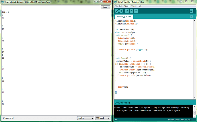

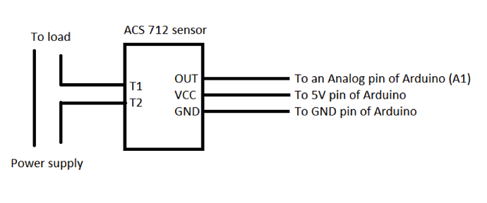

Hello everyone! I'm doing current reading from the arduino Yun with a Current sensor(ACS712) and I'm stuck with the code to measure the current. Here is an attached file for the circuit connection.
When I typed "D" to the serial monitor, the current reading is suppose to come out. However, it is continuously displaying 0 when the light bulb is on/off.

Thanks for your reply!
I changed the codes but it is still not working.. I don't think my connection is wrong either.
The readings are also the same no matter the power supply is on/off when the light bulb is on/off.
Here is the attached file of the arduino reading and code.

I've attached the file!

From your screenshot, your output is changing, varying from 18 to 21. Your code is working.
If those values represent the readings with the lightbulb on and off, and power on and off, then you have a hardware problem. Please post a schematic of your complete circuit, and a clear picture of your actual setup so we can see the actual connection you have made.
My connection(hardware) is exactly the same as this attached photo. Power source to the L of the load, the N goes to the current sensor IP+ and IP- back to the power source. I'm using A0 as the analog input for the arduino!
Are you absolutely positively sure about that? It is still very much worth posting a picture of your actual setup, as you could easily be overlooking a detail that could make a big difference.
I would say that you either have a wiring problem, or you are using a very small load like an LED that has such a low current that the small changes you are seeing are valid. What is your load's expected current?
