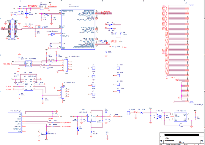

We are working on custom Arduino Mega board and encountered a problem with flashing the card.
There is our scheme:
The reference:
We upload through ISP the images provided at git hub:
But still don't see the board as COM port in device manager and can't upload sketches via Arduino IDE.

Yes, we flashed Arduino-usbserial-atmega16u2-Mega2560-Rev3.hex to 16U2, but still din't see the board in device manager.
I know the 16U2 is USB to serial bridge for Mega2560. If we upload sketches via ISP connector to Mega2560 it works fine.
But the issue is uploading sketches via USB in IDE

The problem seems to be something with ATmega16U2 and USB circuits, FW etc. It has nothing with ATmega2560.

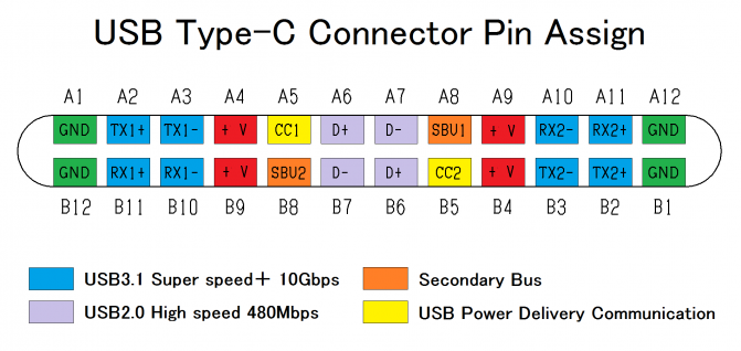

Are you sure the USB-C is connected correctly?
According to pinout seems to be correct

I've never used USB-C but according some designs on the internet A5 B5 should be tied down to GND via 5k1 resistors.
Your schematics is not clear for me, plus it is too small.

Even if the connection is in USB1.1-2.0 mode? USB-C as I know only gaives possibility to use USB3.0 Protocol, but if master both sides useing USB2.0 those pins does nothing.
I'm not sure. As I wrote, I'm not familiar with USB-C but maybe it is way how to force USB 3 to USB2. It is "Configuration Channel".
