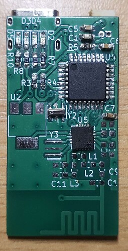

Hello, i have designed a custom board which uses the Atmega328p procesor to connect to a nrf24l01 module, it is meant to be purely a proof of concept and is mostly useless on its own.
The objective of this board was to see if i could make a custom Arduino board and have it connect trough USB to the Arduino IDE + verify nrf24l01 design but that's beside the point.
The board uses the CH340G/C(i'll get to why both later) as the USB to Serial chip connected to a USB-C connector, i have chosen to use a 12MHZ resonator for the CH340G and a standard 16MHZ resonator for the Atmega328p.

this is the current state (only the parts for the Nrf24l01 and the 5v regulator used for Non-USB power are missing)
After plugging it in there are a few things to note, first the Atmega328p chip is functional as evidenced by blinking on the D13 LED (i pre-burned code on it to show that on an Arduino Nano and then de-soldered it off the Nano to solder it on here).
Second, i measured the 3.3V pin on the CH340G and found out that it only had 1.77V however when i soldered on a CH340C from the Nano which i canibalised for the Atmega328p the voltage was now the proper 3.3V.
Third the voltages on the D+ and D- pins after the soldering of the CH340C were 2.5V on D+ (Occasionally dropping to ~1.7V for a split second every 1ish second, this was measured with a multimeter so it could be getting pulled down low and the multimeter didn't have time to react) and on the D- pin there was always 0V.
The final thing i have to mention is that both the TX and RX pins on the CH340C were pulled to 5V, from testing with de-soldered resistors i know that both the CH340C and the Atmega328p are pulling the pins to 5V.
From this i think we can gather that the problem is likely on the CH340C side however i am completely stumped as to where exactly it is.
Ayy, Resoldering half the board fixed it so it was probably some bad solder joint, though after testing it still doesn't work with the CH340G, it could be that i just got a bad batch from china because i tried 2 of them and neither worked but whatever, the CH340C is better anyway since it has the oscilator inbuilt.
Anyways after soldering the parts for the Nrf24l01 i was able to confirm connection with the Atmega328p but it doesn't transmit or receive, only symptom i have right now is the fact that the Radio.write function blocks the code for ~100ms +-10ms. Gonna pry around the library to find out exactly where the hang up is to maybe help find out what the problem is.
