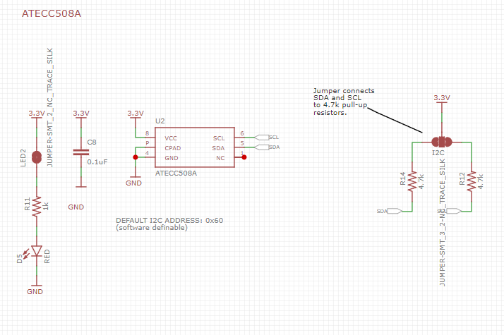

I have encountered an unfortunate problem with my custom board, which has the ATSAMD21G18A microcontroller. I am trying to connect the ATECC508A chip via I²C, but it simply won't be recognized.
I have 4.7kΩ pull-up resistors on the SDA and SCL lines, so theoretically, everything should be fine. Unfortunately, I have no communication with the ATECC508A.
I have tried different bootloaders, but none of them were successful, and I have also changed the address in the libraries (0x60).

I also attach screenshots of the schematic, the board was manufactured at PCBWay.

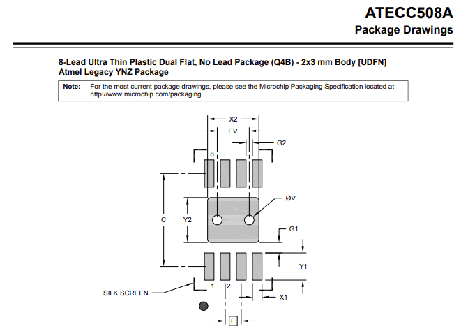

Here's a link to a dahtasheet I found:
Datasheet for ATECC508A-MAHDA-T Microchip EEPROM | Octopart
I see no CPAD, only NC, no connection. Test removing it!
@gamera might be using the the super small 2mm x 3mm (UDFN?) package version of the ATECC508A. The Microchip datasheet says that the centre pad under the chip should be connected to 0V, which I think is what the CPAD pin might be.

I’m exactly using the UDFN 2x3mm ATECC508A-MAHCZ-T chip.
I honestly too can’t imagine soldering such a tiny component myself, but I had PCBWay assemble the board. I actually have a second identical board, so tomorrow I’ll try uploading the I2C scanner to that one. However, I believe the CPAD is properly connected to ground
