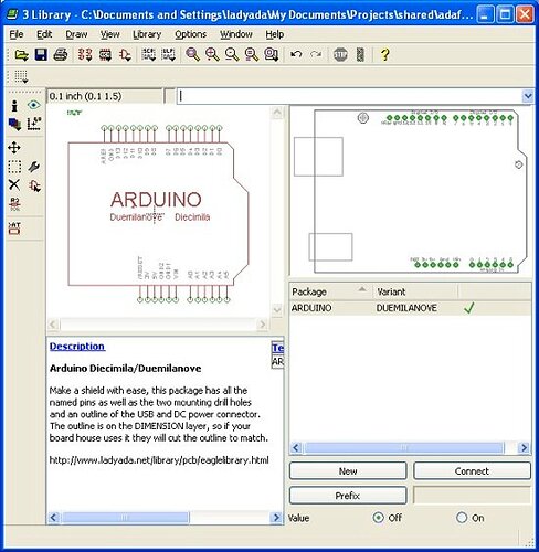

Are you asking someone to develop a shield for you or are you asking if a company will take your design and fit onto an arduino foot print? If you know how to design a board then fitting it on arduino footprint is easy. Just follow links provided by johnwasser. sparkfun also has EAGLE part library that includes several arduino foot print parts.

EAGLE has a free version but if you design boards intended to be sold, you can go with lite version only $59 and limit is 100mm*80mm.
