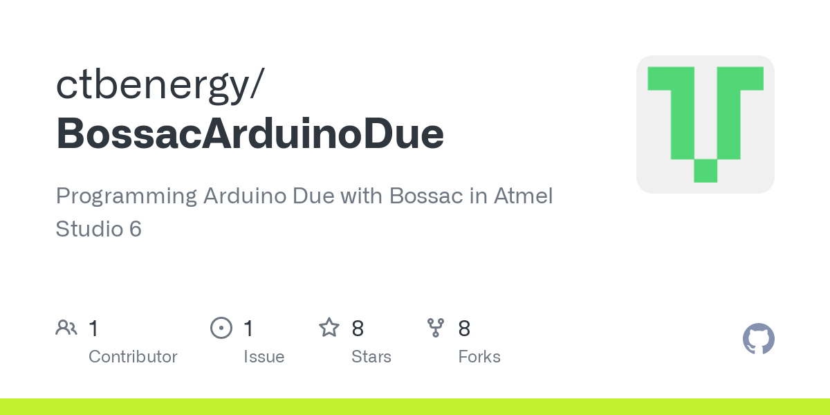

Hi Transistorfips,
The batch-file is now on GitHub. https://github.com/ctbenergy/BossacArduinoDue
If you have some suggestions for improvement, please let me know.

Hi Transistorfips,
Thanks, append the batchjob in the "Build Solution" was a good idear.
I Update the batch-file on GitHub https://github.com/ctbenergy/BossacArduinoDue
Now you can add a "post build command" in the "Build Event" (Debug and Release) "$(DevEnvDir)\BossacArduinoDue.bat" "C:\Program Files (x86)\arduino-1.5.2\hardware\tools\bossac.exe" "$(OutputDirectory)\$(OutputFileName).bin"
For more information see the README file https://github.com/ctbenergy/BossacArduinoDue/blob/master/README.creole
