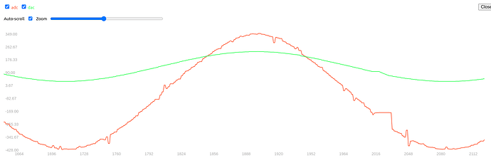

This is the result of plotting what is the value of the variable sineValue
in input to the DAC (in red) - before the DAC actually samples it at 8bits and send it to the pin by the DACwrite - and what is sampled by the ADC in green. The fundamental frequency is the same, at least by eyes, but the artifacts generated by the DAC are evident. What is surprisingly to me is that a) these artifacts have more energy than the fundamental frequency, b) they appears always at twice the signal frequency ... note that we are pretty far from the Nyquest frequency

All works as expected. So I guess the problem is that the interrupts, delays etc in the tasks make the whole process unreliable.
It would be nice to explore what are the exact reasons and still It is quite strange that in the task configuration, the returned frequency is twice the signal one!
