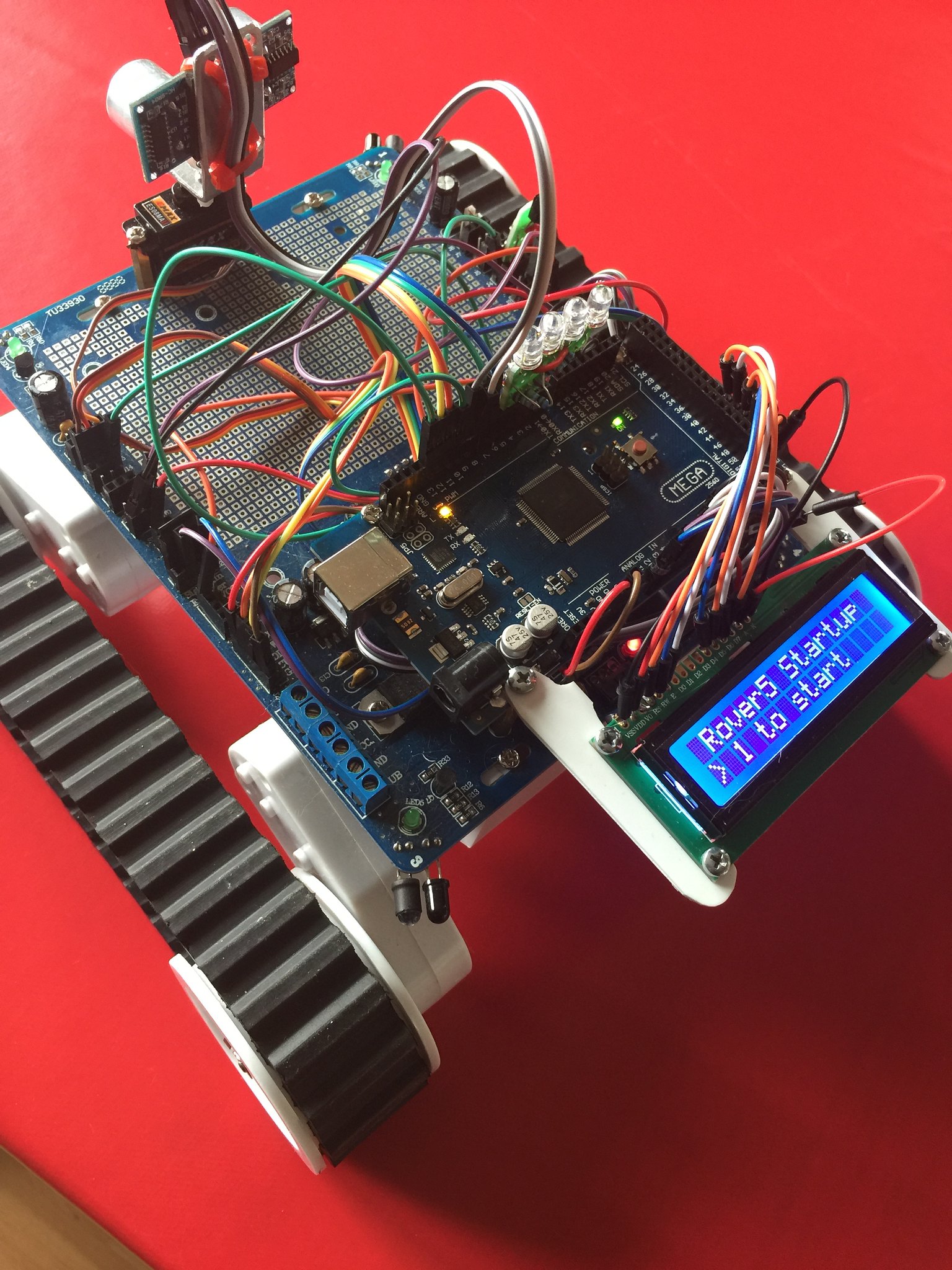

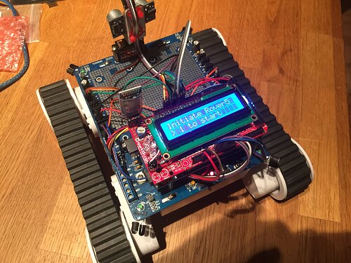

Dagu Rover 5 - Selfmade RF24L Remote control and now with gripper :-)
I’m starting with the Dagu 5 Rover Chassis, in its 2 Wheel Drive form and the Explorer Controller Board for Dagu Rover 5 2WD.
I got it for a nice price :wink:
Controller board
Dagu Rover 5 2WD
I’m not a programmer but I have some experience with coding for the Arduino, but sensors and some of the other electronic pieces that combine to make a functional robot are new to me. Thanks for your help and input.
My first sketch is working fine with a ultrasonic sensor (SR04)

The next step is to use the IR sensors on the Explorer board and here is the beginning of my problems.
When the rover find a obstacle he only drive forward and backward on the same place … on and on and on …

Here is a pic so far ...

Selfmade LCD Shield with IR Remote and Bluetooth and LED’s for direction.
Code is updated, better performance with IR-sensors :wink:
Rover501.txt (11 KB)

I made a remote control Klick ! with Arduino Uno & joystick shield to control the Rover and gripper. The LCD shows the current of the motors and the battery voltages of the battery from the Rover.
|500x433
Way cool !
