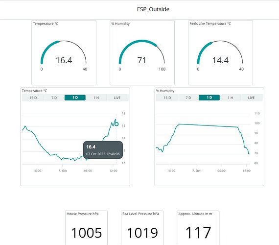

It looks like the updates to the Dashboard is running nearly 2hrs behind!
I have a device that updates every 600 seconds although as shown in the attached image the last dashboard update was at 12:48

My devices are now updating the Dashboard correctly. :slightly_smiling_face:
Me too ! :smiley:
Thank you guys for sharing your experience! My dashboard started working correctly too.
It seems there was some delay in processing data and dashboard was showing values from the past. I wrote about that to the Arduino Support and hopefully they will figure out what has happened. :slight_smile:
