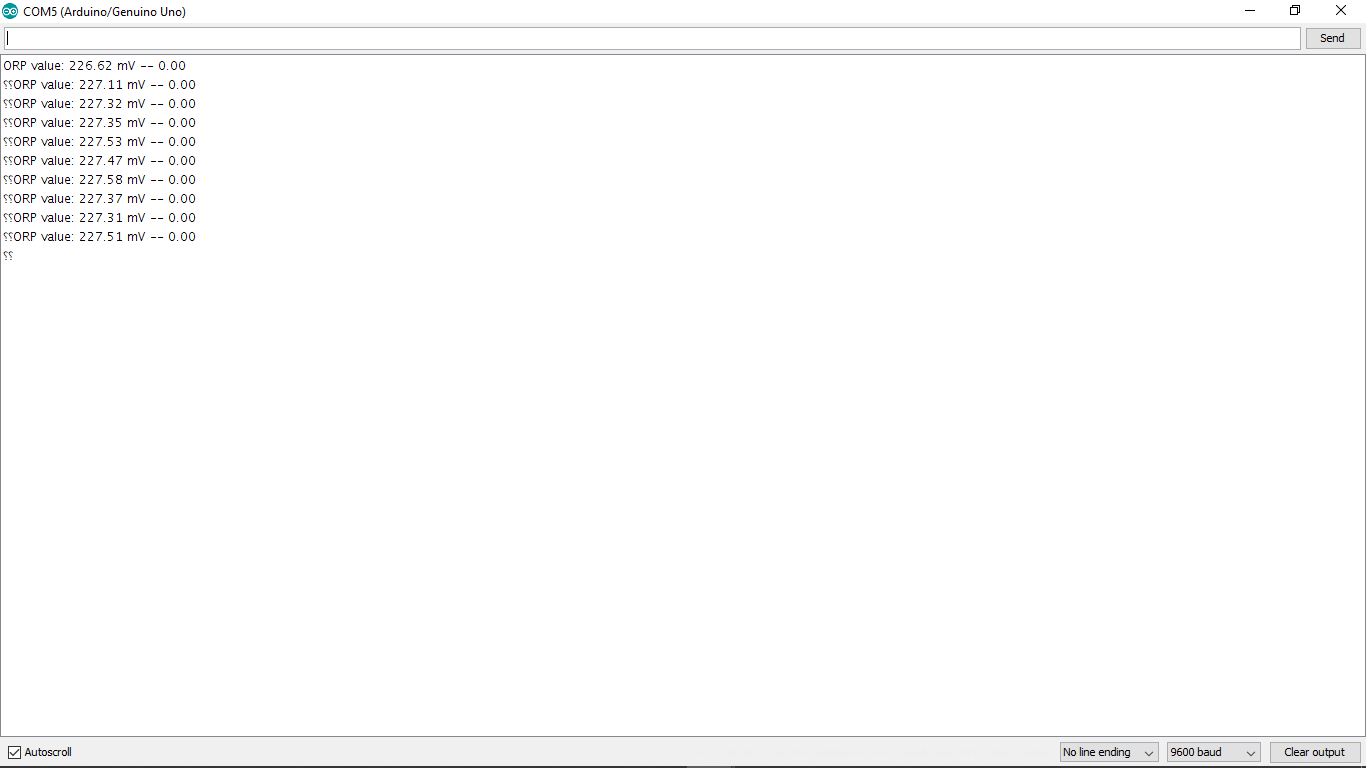

hi i am new here and i face some problem.
i am doing a project require me to measure some reading(pH and ORP) by using some sensor on a slave arduino and send it the master arduino by the mean of I2C. the problem is my reading of pH become 0.00 after send but the reading for ORP is still ok.

You have two pH_Value variables in your code. One is declared globally
double pH_Value;
another is declared static inside loop.
static float pH_Value, pH_voltage;
These are two completely different unrelated pH_Value variables.
You form the result of your measurements on the static variable declared inside loop. But requestEvent sends out the global variable. The global variable is always zero, so you always send zero.
Why did you suddenly decide to declare a static variable pH_Value inside loop? You do not have this problem with ORP_Value variable.

thanks btw, but the problem still there. i wonder where the “⸮⸮” come from and where my “pH value:” goes in this picture…

I updated the post. Did you fix the "two variables" problem?
wow finally i am getting the reading now, big thanks!
something may be wrong with me as its 4am now at my country.
btw i am still trying to fix that missing "pH_Value:" from Wire.print(pH_Value);

i solved the missing "pH_Value" by moving
Wire.print("pH value:");
to before
Wire.print("ORP value: ");
it solve the problem but i dont know why...

Um... You are supposed to keep the global pH_Value and remove the static one. Not the other way around.

Please, post the screenshot of the Serial Monitor of Master that is showing the values received from Slave.
//===Few Comments=================================================
1. The Master has requested for 32-byte data from Slave by issuing this command:
Wire.requestFrom(8, 32);
2. You have queued the following data bytes into the I2C Buffer of Slave for onward transfer to Master.
Wire.print("pH value:");    //9 bytes (ASCII codes)
Wire.print(pH_Value);                 //3/4 bytes (ASCII coded) range:00.00 - 14.00
Wire.print("ORP value: ");           //10 bytes
Wire.print(ORP_Value);               //6 bytes? xxx.xx
Wire.println(" mV--  ");               //7 bytes
3. You have queued 36 bytes data (Step-2); but, the Master is reading only 32 bytes in Step-1. Why is this mismatch? Try with this command at the Master side:
Wire.requestFrom(8, 36);
4. As you are not sure about the number of digits present in the float type variables pH_Value and ORP_Value, it is safe to send the binary32 formatted (4-byte) values for these variables instead of ASCII coded values. The procedures are:
