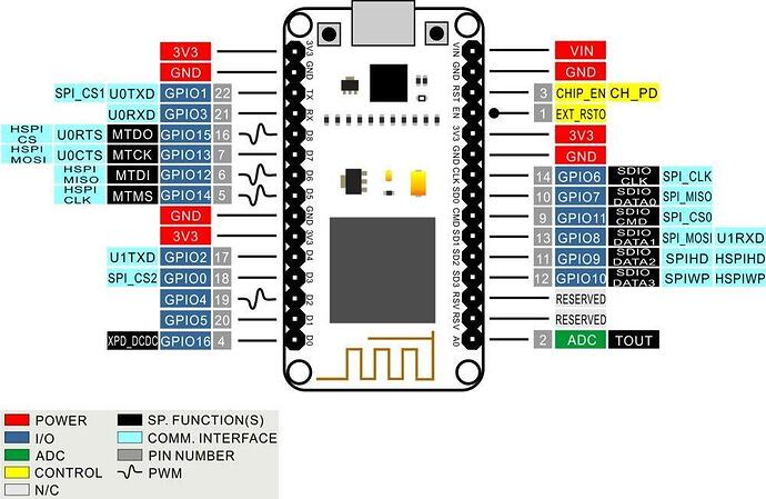

Hello everybody,
for an educational project in a geography class we want to create a couple of data loggers.
They should record time, air temperature, rel. air humidity and atmospheric pressure on a SD card (to make it easier for the students to read out the data). No WiFi will be available at the locations.
To be able to compare the data between the single loggers, the data should be logged at every exact minute - though every 5, 10 or 15 minutes would also be sufficient.
As micro controller the ESP8266 NodeMCU 12E (Arduino Nano or so could be an alternative?) was chosen, as sensor the BME280, as RTC the DS3231 and a standard SD card adapter.
The energy is currently supplied with 4x AAA batteries via micro USB.
Below, I have posted code which works fine so far... but also with modem sleep after abt. 25 hours the batteries need to be replaced / recharged. :-\
Maybe, somebody can help to make it last longer? ... 3-4 days recording time would already be enough.
Thank you very much in advance!! :slight_smile:
Wiring:
BME280, DS3231 <> ESP8266 NodeMCU 12E
SDA <> D3
SCL <> D4
VIN,VCC <> 3V3
GND <> GND
SQW (just DS3231) <> D1
SD Card Module <> ESP8266 NodeMCU 12E
CS <> D8
SCK <> D5
MOSI <> D7
MISO <> D6
VCC <> VIN
GND <> GND
Power Supply via microUSB

"Maybe, somebody can help to make it last longer? ... 3-4 days recording time would already be enough."
Well, the simple answer is to get bigger better (preferable rechargeable) batteries to power the project. Surprised nobody thought of that.
ESP8266 is a poor choice, quite a high running current.
An Arduino Pro Mini, modified, running from a LiFePO4 battery direct, so no regulator needed, would be a better choice.
Choose the BME280 board right and they have a deep sleep current under 1uA.
A PCF8563 RTC has a very low running current well under 1uA, you can set an alarm to wake the processor every minute.
Setting the time for the RTC could be done with a GPS, just remove it when the RTC has the time or set the time manually.
The easiest 'logger' to use is an Openlog, cheap on eBay, just plug it into the Serial program port on the Pro Mini and it records whatever you print to the serial port.
Now you might be lucky and find a MicroSD card that only takes a few mA, in which case with the rest of the stuff only using about 2 - 3uA when asleep, you have a battery life of several weeks.
Do the 'logging' bit remotely, via say a LoRa link, and battery life stretches to months or years.

You'll need to measure what's drawing current between readings, but I would predict that the SD card would be a major culprit. This will vary considerably with the brand of SD card, but will probably be in the range of about 2mA to as much as 20mA in an idle state. So you might consider rigging up a transistor to power the card, and shutting its power down completely between readings.

Apart from that, does somebody have an idea if just by an optimization of the code more power can be saved?
E.g. if there is a certain function to send just single parts like the SD card module to some kind of sleep mode?
Starting with a large program and trying to 'optimise' it for low current operation is a mistake in my view.
Start wit the basic microcontroler with nothing else connected.
Measure the idle current.
Put the microcontroller into a deep sleep to wakeup in say 60 seconds, measure the current.
Add the sensor, measure the current etc.
Put the sensor into deep sleep etc, measure the current.
Etc, Etc.
