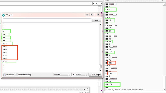

Data not correctly using Bluetooth
Using Bluetooth (the problem) 1
When using Bluetooth, the data is turned off for a period of time(data freezing), and the data is output randomly (note that the same code is used)
Using serial Port (it's work)

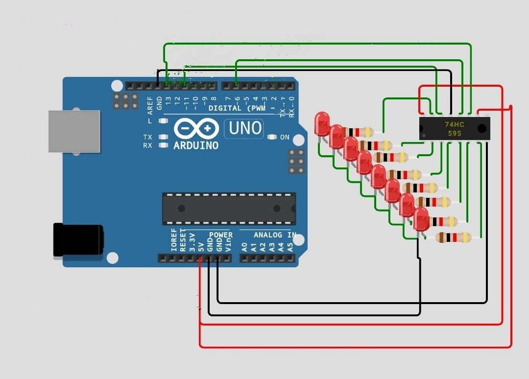

Are you using two arduino's both running the posted code? How can that result in something being transmitted at all?
One Arduino add the lower wiring diagramme to the upper one
Not understood.. Everything is connected to one arduino or what? What is transmitting to the arduino? Using the same serial connection for both bluetooth and serial debugging?
Yes...Previously I used serial port to send data from vb 6 to arduino it works, problem when developing using basic4android to send data to arduino via bluetooth incorrect data at character (À,à)
The data in the serial monitor comes in sets of 4 lines. One line is the characters binary value, then the hexadecimal value, then the decimal value and lastly the character itself. One of the sets is:
BIN  : 01110000
HEX  : 70
DEC  : 112
CHAR : p
The serial monitor is AFAIK unable to print extended ASCII characters and if such a character is found it will be substituted with a similar character. Decimal value 192 is "α" which becomes "à" and so on.

Yes, but it does not arrive to the Arduino, this is shown in the first picture (((serial motion))), marked in red, which is the problem
How can you receive anything without a connection? You are printing to serial monitor with a serial connection where a bluetooth tranciever is also connected, so what you print to serial monitor is also transmitted via bluetooth. Without knowing how the receiving end of the bluetooth connection handles incoming data it is hard to guess what causes the problem.
I depend on the translation...maybe some of the words are wrong...I mean (transfer from to)
