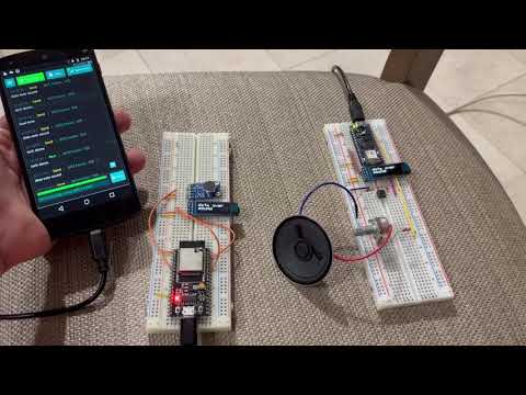

Hi, I have been developing a data-over-sound library and I recently ported it for micro controllers. I have implemented a few examples that can get you started immediately:
Here is a short video demonstration of Arduino, ESP32 and Android phone communicating through sound:
The library currently supports mono-tone and dual-tone protocols. It has built-in forward error correction using Reed-Solomon codes. You can optionally enable Direct Sequence Spread mode which seems to improve the robustness of the transmission. I think the reception is pretty good within 50-100 cm distance. With default protocols you will get between 5-10 B/s data rate.
You can use the Waver v1.5.0 app to do quick tests as demonstrated in the video.
I think the Arduino RP2040 example should work also with Arduino Nano 33 BLE Sense, but I don't have one to perform the test. The benefit of using these microcontrollers is that they have a built-in mic, which seems to be with very good quality.
The ESP32 example uses external analog microphone modules. I have tried using MAX9814, KY-037, KY-038 and WS Sound sensor and they all work. I just connect them to the 12-bit ADC and setup I2C DMA to process the data in real-time.
Hope this helps!
