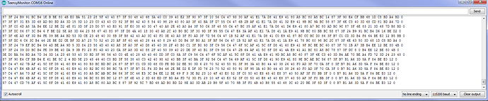

I am trying to receieve a data packet of 70 bytes from one board to another with serial.
What i get when printing the characters will be shown in attached picture.
I believe these are ASCII symbols.
The baud rate has been checked and the data has been verified correct through RealTerm. So the board that sends data is really working properly.
My question is how can i transform these symbols into useable numbers since the packet is like this:
I would like to have a value of pressure that i can use for calculation further.

Thanks for the reply.
I will attach one picture "data_packet" which describes the packet that is being send from another board. I cannot modify this since this board has been bought like that.
Also i will attach one more picture where you can see now the output with HEX format.
My main objective is that i want to have that float value for each pressure i receive (please look at data_packet graph), so that i can manipulate after with it.
It seems that union function from my code does not give reasonable values. In my union it transforms characters into float. In the end if i print conv.f i get random numbers and sometimes ovf.
Thanks for any further help

can you post an example some Realterm output as text
Ok first i will attach description of the packet that is being sent. Two graphs attached.
With the code from above i get something like this:
3E 68 DD A8 BD D2 9E C7 3D 3D 23 B0 6E 40 80 C8 3F F8 50 40 50 55 40 F8 42 40 A0 F9 3F 50 C6 3F A9 E8 C3 47 DF A6 B7 41 EB 51 EC 41 DE E3 41 D5 BC A2 BB 14 87 3F B7 11 97 3D 68 A1 BD A4 9D 5 3D 59 23 B0 6E 40 <
89 3C 70 9 19 BC DA 23 18 5F 40 A0 CD 3F E8 49 40 B0 48 40 E8 3C 40 F0 BF 3F E0 EF 3F BF E8 C3 47 F AC B7 41 EB 51 EC 41 38 E3 41 80 E6 BC 74 BB 68 87 3F DC 86 87 3C 68 9D 89 BD A4 3D 15 3D DA 23 88 5E 40 C0 <
89 3C 70 89 57 BC 94 23 70 6A 40 C0 DB 3F 8 4B 40 38 59 40 78 46 40 B0 D9 3F E8 3F A9 E8 C3 47 3C B1 B7 41 EB 51 EC 41 66 E3 41 80 F0 BC C4 BB 52 87 3F 24 79 EF BC 68 8D DF BD A4 5D 63 3D 18 23 20 70 40 70 D0 <
87 3F 92 1C 65 BD D0 BA 54 BD A4 BD 53 3D BC 23 18 5F 40 50 C2 3F E8 49 40 B0 5D 40 A8 36 40 40 D1 3F 10 D6 3F 3A E8 C3 47 D4 B3 B7 41 EB 51 EC 41 C0 E2 41 80 E4 BC A4 BB 6 87 3F C0 6D A8 3A A0 F5 ED BC 48 BB <
23 28 6A 40 80 CC 3F E8 52 40 68 72 40 F8 42 40 40 DA 3F 10 D6 3F 40 E8 C3 47 C8 C0 B7 41 EB 51 EC 41 66 E3 41 80 E7 BC A0 BB 36 87 3F 48 72 26 BC B4 4E 3 BE 80 4B E0 BA EF 23 F0 48 40 F0 BE 3F 70 55 40 E8 51 <
87 3F 90 E4 CF BB B4 A6 1E BE B8 C4 E8 BC 63 23 18 61 40 B0 DF 3F 30 4C 40 18 51 40 30 48 40 A0 D4 3F 40 F8 3F 2A E8 C3 47 61 C3 B7 41 EB 51 EC 41 D8 E2 41 C9 BC 90 BB 2A 87 3F B8 8D 50 3C D0 3A 16 BD E0 12 B5 <
89 3C A4 1D 44 3D 63 23 C8 64 40 40 ED 3F 20 4E 40 60 5F 40 48 40 40 F0 F2 3F 30 C5 3F 2A E8 C3 47 F9 C5 B7 41 EB 51 EC 41 D8 E2 41 80 E1 BC AE BB 36 87 3F 49 3E A9 BD A0 75 AF BC D2 9E C7 3D 5E 23 8 69 40 50 <
89 3C 70 9 19 BC 1F 23 8 69 40 50 DC 3F 60 5B 40 8 61 40 18 4F 40 50 F2 3F 30 DC 3F 2A E8 C3 47 61 C3 B7 41 EB 51 EC 41 8 E3 41 E1 BC 8E BB 22 87 3F DC C6 A6 3C A0 35 90 BC 48 FB EB 3C 23 28 6A 40 90 EB 3F <
3E 51 23 88 71 40 40 D7 3F 4F 40 20 64 40 78 4B 40 A0 CF 3F 80 CC 3F 2A E8 C3 47 56 D0 B7 41 EB 51 EC 41 A8 E2 41 E7 BC 7C BB 22 87 3F 49 6E A1 BD 68 8D DF BD D2 5E A8 3D 2C 23 40 6F 40 A0 E7 3F 61 40 E8 51 40 <

      Compute Pressure and display.
      Begin from Label A
   Begin from Label A
3. Arduino Coding of the algorithm of Step-2
Sender UNO Codes
#include <SoftwareSerial.h>
SoftwareSerial mySUART (4, 5); //SRX, STX
byte sendData[] =
  0x23, 0x00, 0xE8, 0x43, 0x40, 0x00, 0x80, 0xCC,
  0x3F, 0x00, 0x60, 0x44, 0x40, 0x00, 0x40, 0x47,
  0x40, 0x00, 0x18, 0x1F, 0x40, 0x00, 0x00, 0xBC,
  0x3F, 0x00, 0x20, 0xC3, 0x3F, 0xD8, 0x87, 0xC2,
  0x47, 0xDA, 0x59, 0xAF, 0x41, 0x1E, 0x85, 0xE7,
  0x41, 0x00, 0x3E, 0xE1, 0x41, 0x00, 0x00, 0xC5,
  0xBC, 0x00, 0x60, 0xA7, 0x3D, 0x00, 0xD6, 0x87,
  0x3F, 0xB8, 0x8D, 0x50, 0x3C, 0x68, 0xED, 0xCF,
  0xBD, 0xD2, 0x1E, 0x89, 0x3D, 0xD7
  mySUART.begin(9600);
  for (int i = 0; i < sizeof(sendData); i++)
    Serial.print(sendData[i], HEX);
    mySUART.write(sendData[i]);
  Serial.println();
  Serial.println("================================");
  delay(2000);
Figure-1: Serial Monitor of sender UNO
Receiver NANO Codes
#include<SoftwareSerial.h>
SoftwareSerial mySUART(4, 5); //SRX, STX
bool flag1 = LOW;
byte recData[68] = "";
byte frameMarker;
byte chkSumRec = 0;
byte chkSumCal=0;
int i = 0;
  if (mySUART.available() > 0)
    if (flag1 == HIGH)
      recData[i] = mySUART.read();
      Serial.print(recData[i], HEX);
    //  chkSum += recData[i];
      i++;
      if (i == 68)
        chkSumRec = mySUART.read();
        //chkSum = chkSum - mySUART.read();
        //if (chkSum == 0x00)
      //  while(1);
        Serial.println();
        Serial.print("Received chkSumRec: ");
        Serial.println(chkSumRec, HEX); //received chkSumRec
        chkSumCal = frameMarker;
        for(int i = 0; i<sizeof(recData); i++)
          chkSumCal += recData[i];
        Serial.println();
        Serial.println("Calculated chkSumCal = ");//Valid frame is received!");
        Serial.println(chkSumCal, HEX);
        i = 0;
        flag1 = LOW;
        Serial.println();
        Serial.println("=================================");
      } else {}
      byte x = mySUART.read();
      if (x == 0x23)
        Serial.println("Marker is found!");
        frameMarker = x;
        flag1 = HIGH;
Figure-2: Serial Monitor of receiver NANO
4. Now, the frame is well received and all the 4x17 (68-byte) data for 16 different pressures are available in recData[] buffer of the Receiver NANO. You can now process this data using union structure to find the individual pressures an display them.
Hints:
union
   byte press_0Array[4];
   float press_0;
}pressure_0;
for(int i =0; i<3; i++)
  pressure_0.press_0Array[i] = recData[i];     //assume receied bytes are little endian oriented
Serial.println(pressure_0.press_0, 2); //Pressure_0 = xx.xx units (mbar?)
GolamMostafa:
Hints:
union
  float press_0;
}pressure_0;
Wouuu! Awesome job. It works nicely!! Thank you very much!!!
