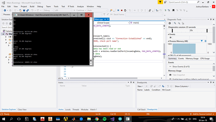

Hi guys, I am using my arduino as an ADC to calculate flex sensors angles, in total I have 6 flex sensors. The angles calculated from the arduino are then transferred to the pc via usb and inputted in a c++ code to rotate 6 smart servo motors. I managed to control 1 motor with 1 flex sensor, the problem is that the data from the arduino is being inputted as a group so I can't access each sensors data individually and assign it to its respective motor, is there any way that I can do it?

The data is separated one after the other each sensor in a new line, and yes I have control on the type of data being received.
So you are sending all of the data that is in the screen shot to the PC application? I think that you would be better off sending a structured packet of comma separated values to the PC. Much easier to parse. I would send just the raw ADC output values. Then do the calculations for resistance and bend angle in the PC app.

I managed to improve a bit the system and the output is giving only integers as attached, what is a structured packet of comma separated values, in this way can I access each value individually?
The concept of comma-separated-values (CSV) is very common in computer programming. Google it.
It is used in the 3rd example in Serial Input Basics (which was linked to earlier)
Sending data is that format is as simple as

Fine I used the comma seperation and I got for example <0,1,0,-1,0,0>. Can I know get the value of 1 for example and use it in a function not the whole group of data?
Again referring to Robin2's serial input basics example #5. Use the receive function to get the data. Modify the parseData function to strip off the 6 integer values into each their own variables with the atoi() function.

The program is receiving data from arduino, but each sensor is assigned to a specific motor. So I need to assign the 1st digit in the csv to the 1st motor. using serial input basic example 5 is there any other example with all integer variables and keep in mind that these values are constantly changing?

Look here for strtok() reference.
Here is example #5 modified to parse integers (unfinished).
void parseData() {      // split the data into its parts
    strcpy(tempChars, receivedChars);
    char * strtokIndx; // this is used by strtok() as an index
    strtokIndx = strtok(tempChars,",");      // get the first part - the string
    FSR1 = atoi(strtokIndx); // convert this part to an integer
    strtokIndx = strtok(NULL, ","); // this continues where the previous call left off
    FSR2 = atoi(strtokIndx);     // convert this part to an integer
    FSR3 = atoi(strtokIndx);
    FSR4 = atoi(strtokIndx);
