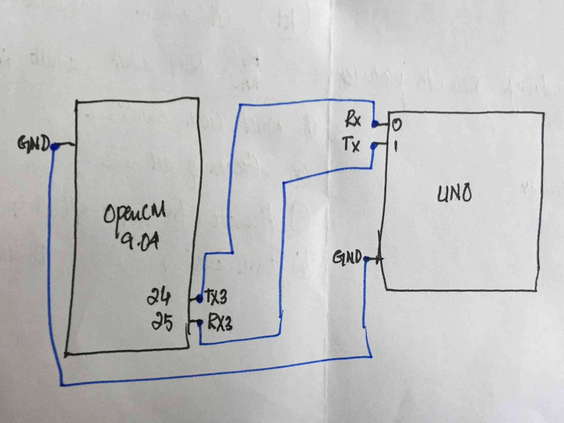

Hello everyone, I am trying to transfer some data from Arduino UNO to OpenCM board using the below example sketch (Arduino IDE software). It seems the OpenCM9.04 is not receiving any data, however the same code is fine while using with two arduino boards (UNO, and Mega). The hardware connection of Arduino UNO and OpenCM9.04 is shown in figure.
Hardware connection
Example Code

It would be grateful if anyone can suggest or help me that where I am doing wrong and how the data can be transferred between these two boards. Thanks in advance

by the way: the OpenCM seems to be a 3.3V device while the Uno is a 5V device.
You may have damaged your OPemCM through directly connecting it to 5V

Yes I know these serial communication pins and have tried with TX1-RX1 to TX3-TX3 pins but none of them worked.
The both boards (UNO and OpenCM) are powered through their USB ports, therefore there is no any connection of voltage between them. Only he GND, TX and RX pins are connected between them to transfer the data from one board to the other.

The IO-pin of an Arduino-Uno "sends" out 5V but the serial interface-IO-pins of the OpenCM is build for only 3.3V.
This means the Arduino TX-pin "feeds" a too high voltage into the OpenCM-Rx pin and this might have damaged the OpenCM
