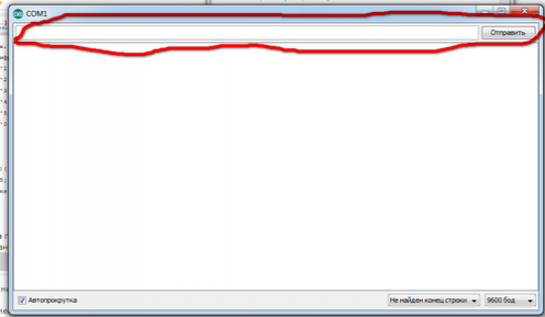

Launch and receiver silence. Only works when the data is transferred to himself through
Prompt where the error what is wrong???? possible to fix the code!
It is very necessary!
I apologize for my English!
Your sending sketch doesn't receive any radio messages so it is not necessary to start and stop listening.
Your serial port handling code looks wrong. I haven't look at the message format you're trying to use but it looks as if you expect to receive multiple bytes from the serial port and that there will always be a complete message available. That isn't right - the message will come in slowly one byte at a time and if you want to process a complete message you will have to buffer the bytes as they arrive and work out when you have received a complete message.
On the receiving side you only process the first byte in the payload although there may be up to 32 bytes of useful data there.
For the purpose of testing the radio part, I suggest you disable all the serial port handling and just send a fixed hardcoded message and confirm it is received OK. Then you can check how fast and how reliable that is before you design the rest of your solution around it. Depending how fast you receive input on the serial port, you could easily find that the RF24 can't keep up when it is transmitting a message per byte.
The code to work out what number you have received is very repetitive and you could avoid the repetition by converting the character to a number and doing a range check on it.
if(isdigit(data[0])
  byte value = data[0] - '0';
  if(value == 0)
    resetLEDs();
    digitalWrite(pins[value-1], HIGH);
  // unexpected character ignored
If I were you I would connect the receiver to a PC and use the serial port to tell you what it is doing. (Even if there won't be a PC available in the final system, use one for testing.) In that case you must avoid using digital pin 1 in your sketch since the hardware serial port uses it.
