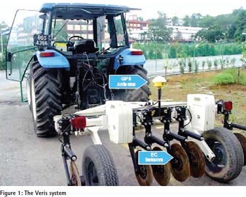

I will build the weighted toolbar and pull it behind a tractor. The electrodes (AMNB) will be 20 inch coulters with a total width around 12 feet. I need a point recorded every second so that I can travel 7 mph. That will give me a data point every 10 feet or 360 data points per acre. I can convert the point data into a raster and calculate from there on GIS.

Here is a pic of what I have in mind for the implement.
The "electrodes" I will use will be discs rather than prongs. I have watched disks (coulters) in the ground on other farm equipment. A scoured (shiny) coulter deep in the ground will not pull or disturb soil. The leading edge of the coulter will cut through the soil and have a great deal of pressure as it moves along. I plan on using 20 inch coulters which should give me a depth of about 8 inches I theorize the electrical currents will take the past of least resistance off the leading lower edge of the coulter where the ground pressure is highest. I have found some information where EC mapping tools have a water tank that dribbles a very small amount of water on each coulter increasing soil connectivity.
Insulation from the tool bar: High quality (UHMW) polyethylene. I have used this product in other repairs on the farm. It is a very durable product. I will make collars that fit over the tool bar where the coulters clamp on with "U" bolts. The electrical connection will be made on the coulter mounting frame. (Which I will check for any potential resistance before construction.)
In my research a 110 volt / 500 watt AC power supply will be sufficient. This is what I will start with anyway. AC current is better for soil conductivity measurement. Using AC current has led me to some more research on the Arduino. Measuring AC Voltage / Current adds an extra layer.
