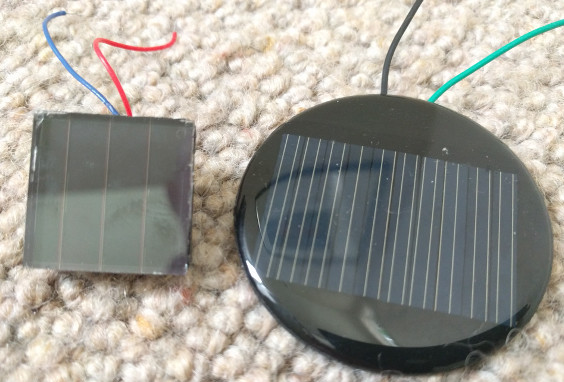

While developing a Solar Power sensor to add to my weather station, I hooked up a small Silicon Solar Cell rescued from a LED Garden light to an Analogue Port. (see photo) I found the open circuit voltage gives a very clean signal rising quickly at dawn and falling the same way at dusk. It does not require direct sunlight and appears to be quite tolerant of variations in ambient daylight eg clouds (probably because it is unloaded to a large degree). It produces a very clean zero signal at night time. (see graphic)
So if you are looking for a sensor to control your pet doors, animal feeding regimes, blinds, irrigation or whatever this maybe quite useful to you. I am still experimenting with a load resistor to get a better idea of solar 'power', but I thought this preliminary observation maybe useful for other projects.

Don't forget to use a (10k) resistor between solar+ and analogue (or digital) input.
Even this small cell can put out enough current to phantom-power un unpowered Arduino through the input pin.
Add a 100n cap from Arduino pin to ground, and you also have some RF rejection in case a long cable is used.
Leo..
10k. By coincidence that was my first choice as a load. I am thinking maybe 500R-1k maybe needed. Cable very short so no capacitor required, it appears very immune noise anyway.
I did not mention "load".
10k between solar+ and the "very high impedance" input pin does not "load" the cell at all (when the Arduino is on).
The 10k series resistor prevents the Arduino being powered through the pin protection diodes when the Arduino happens to be off and the cell is in sunlight. That could fry the pin.
If you want to load the cell, use a resistor across the cell.
But that seems not needed if you look at the graph.
Leo..
I tested the cell in full sunlight and it just scraped a little over 2volts. The system has a rechargable cadmium cell inside (only 1.2V) and the LED is white so probably requires about 3V at least, hence the little inverter chip. I don't think the Arduino Pro is likely to fire up on 2V, maybe 2.5V. However for others who try this, find the maximum voltage of your solar cell before you ignore wawa's advice. The two cells in the attached photo are different. The smaller square one is the type I am recommending. Whereas the circular type generates about 5-6V!! So it must have a couple of cells in series inside the one package. I intend to use the circular cell(s) to charge the battery that will ultimately power the sensor. So it maybe possible to just go with the circular system and use a voltage divider and the computer (UV sensor and Lightning detector) et al will be the load?

The 10k resistor is too light a load on the square solar cell as it climbs to near peak voltage early in the morning, even without direct sunlight. I feel it is not working hard enough. Very overcast today so I can not begin to check it. Though when lightly loaded it could move quick enough to come close to discriminating different levels of "Dusk" if required.
