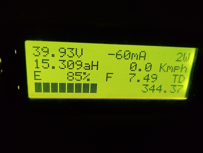

I originally had a 20x4 green backlit with black character lcd display. In daylight I could not see the backlight but the display was readable. I need more information on the display so I was thinking of switching to 128x64 green backlit with black character GLCD display. But have found other alternative, Chinese 2.8 inch TFT LCD display costing just 150 INR($2) more.

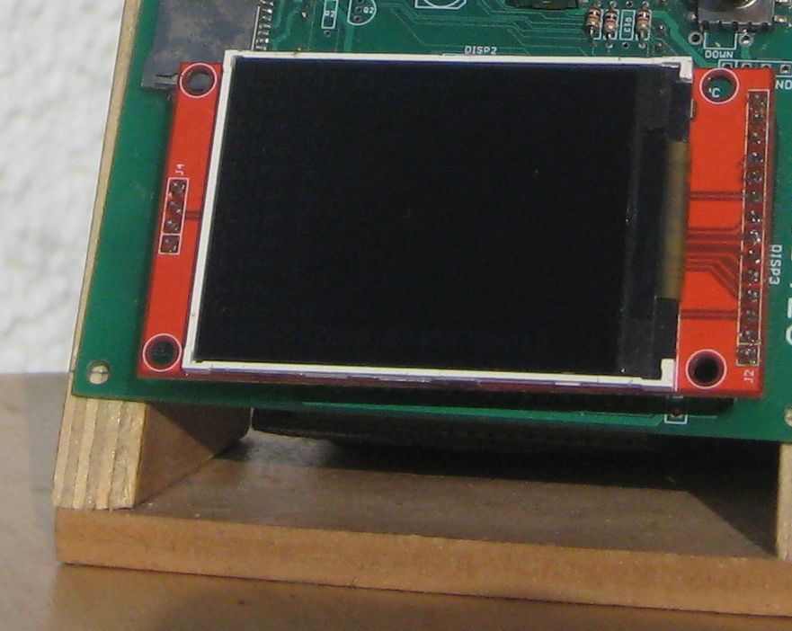

Chinese 2.8 TFT display
My concern is are these display readable in sunlight? A picture available in another post (by another user) shows how the 20x4 display was readable in sunlight
TFTs and OLEDs are more or less invisible outdoors when its sunny. TFTs are sometimes called LCDs, when clearly they are not. The red display you showed is a TFT, assume its invisible in sunlight.
The 20x4 display you showed is a transflective LCD, highly visible even in direct sunlight. Standard LCDs are not so good in sunlight.

I have used exactly that type of display (the red TFT) outdoors in sunlight, they are next to invisible.

Here we go, not in the brightest of sunlight, its winter here, and there was a slight bit of haze in the air. First is display pointing at sun, displaying is text as you cannot see. Second is display pointing away from sun so in shade.
Are these photos with backlight LED on?
Of course.
If you dont turn on the 'backlight' there is no visible output from the display.
Have you used a TFT display before ?
No, trying for the first time. I had an idea that without the led backlight on it would not display anything but I thought why not ask and confirm rather than assume.
Have you worked out what text messages are on the TFT screen, you can just about see text on the image that is in the shade ?

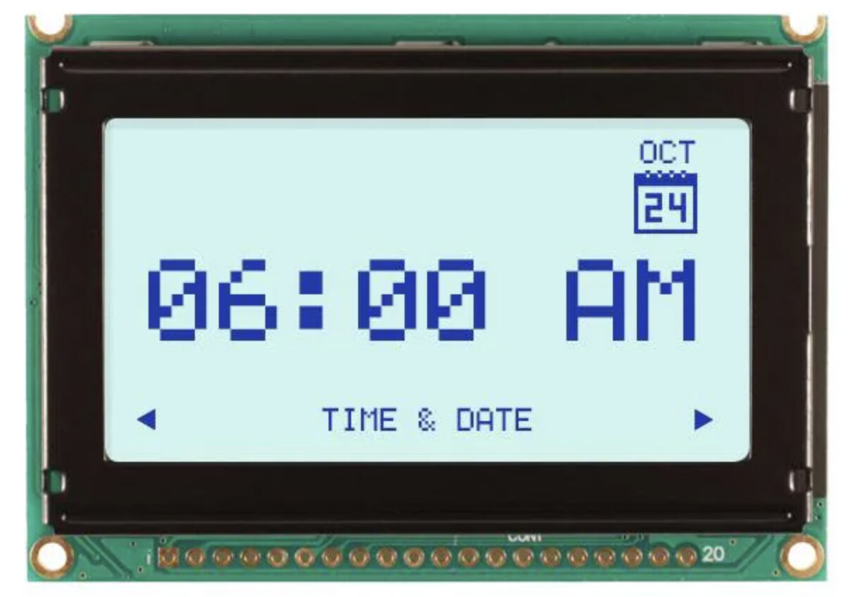

Search for something like this transflective display.
128*64 serial GLCD display with green backlit is costing me INR500 and this display a parallel interface is costing INR 2300.
