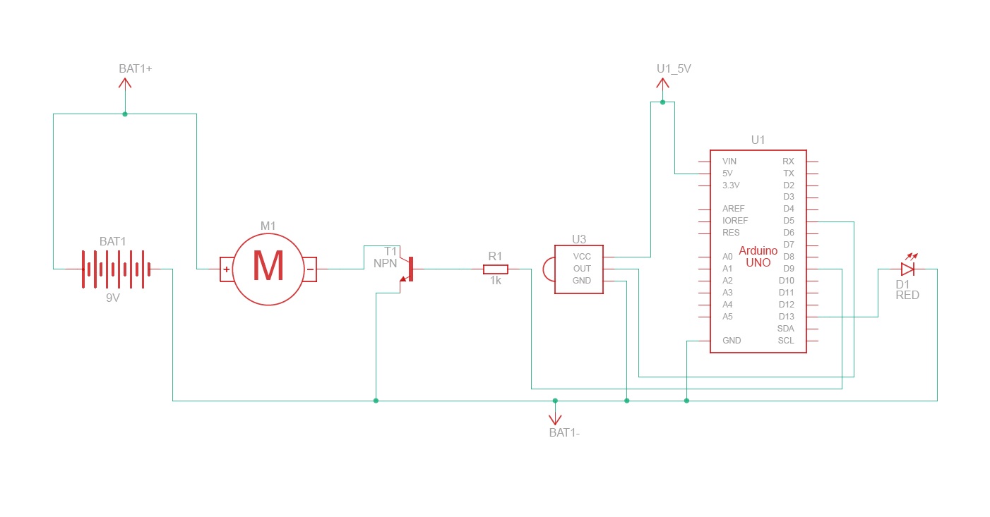

Hello , i was creating a project where i was gonna control DC motor speed using Arduino PWM, , while using a max 100mA of current from my 3,7 volt battery, while the DC motor have internal resistance of 3 ohms, but it wont Turn on if i but any resistors to limit the current to 100mA, should i buy a different DC motor or Something else is the problem?

3.7/3 =~ 1amp
Hopefully you aren't running the Arduino from the battery? As hammy points out, the start current of the motor is over 1 amp but when it's running it will be much less. What type of battery is it? 3.7v could be a coin cell or a big LiPo cell, no chance of a motor running in the first! You don't want to put any series resistor in, but make sure the supply can manage the start current of the motor. And supply the details he mentions.

, in tinkercad it works but in real life motor only responds to 255 PWM not any lower
Please post your schematics as EXPORTED jpg or png and post the image into the thread.

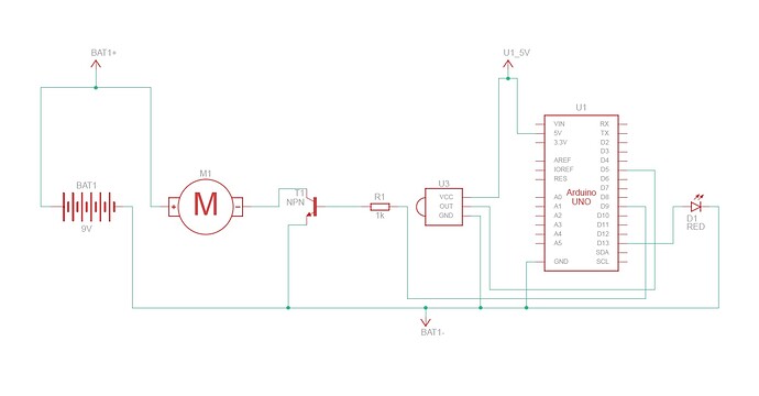

@lucaswilliam7868 schematic.

What is the BJT, T1.

R1 limits Ib to about 4mA.
Your motor "wants" about 1000mA.
So you need a transistor with an HFE (not Hfe) of 1000/4 = 250.
There is no such beast.
Change your circuit to use a mosfet - like this
as shown you will also need to add a protection diode across the motor.
