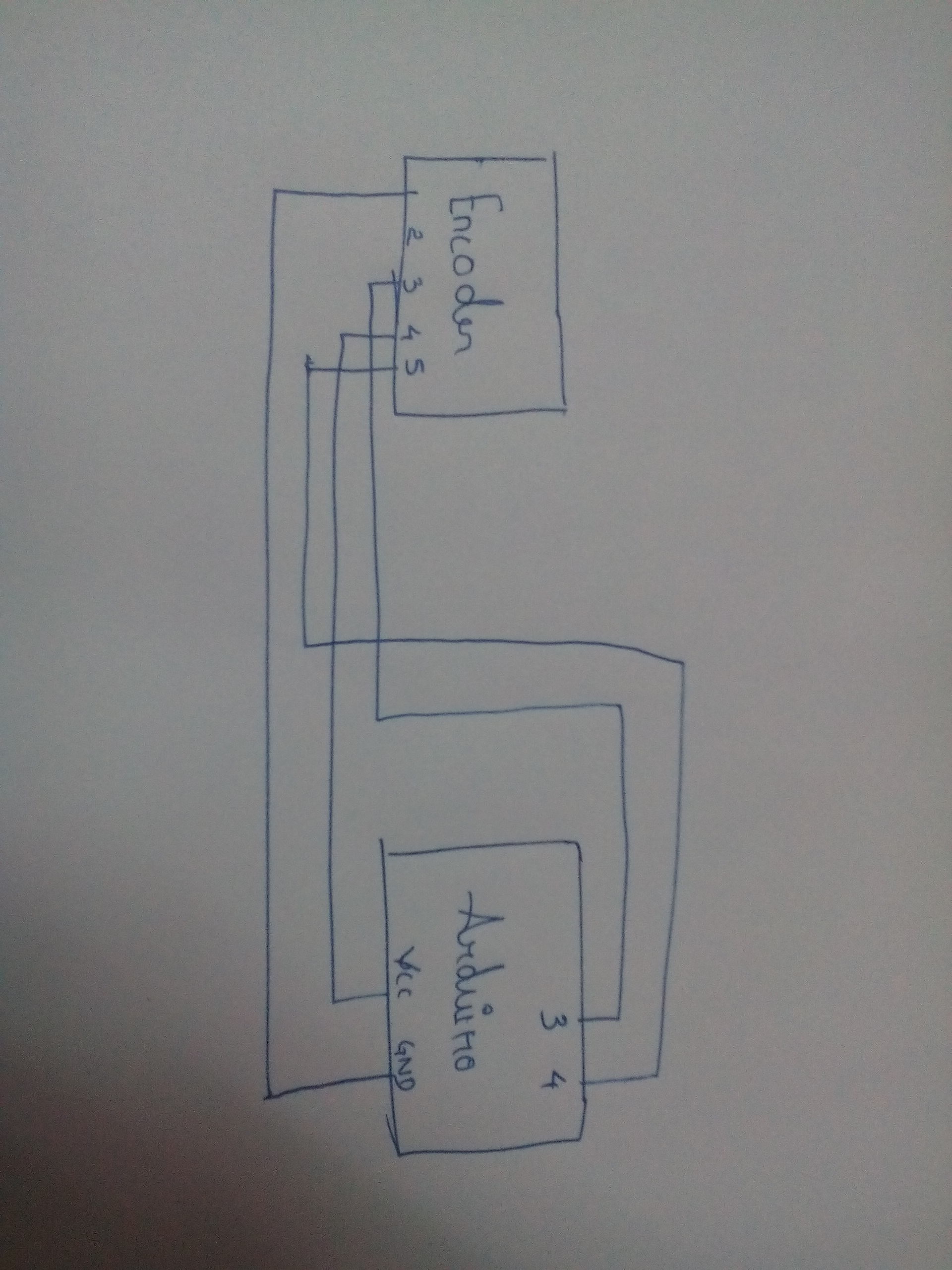

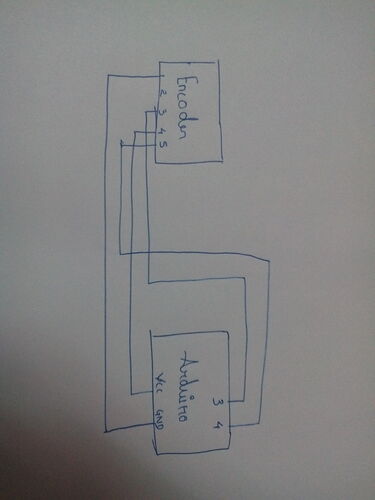

This is how I connected my encoder and arduino.
Put these in setup
digitalWrite(encoderA,HIGH);
digitalWrite(encoderB,HIGH);
Use your own variable names.
