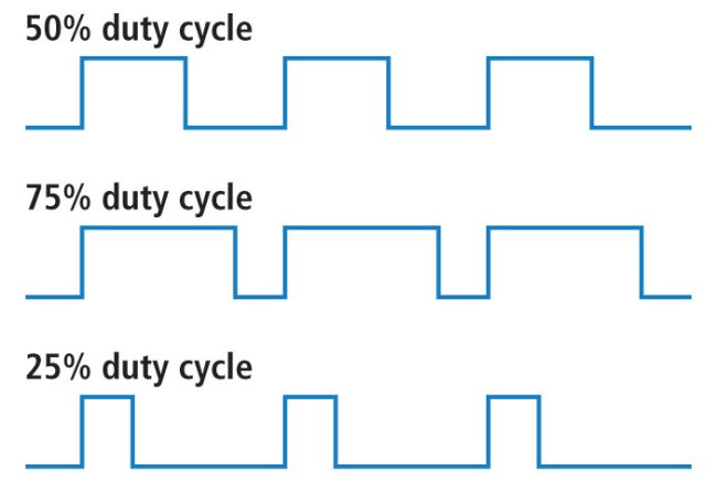

The beep sound comes from the PWM. The PWM has that frequency you hear. At full duty PWM you won't hear it because the motor runs and keeps noise and probably won't have any parts resonating with the PWM frequency. At half duty you might hear it, especially if the motor doesn't run on half duty. Instead it catches the PWM frequency and resonates with it, creating the beep. At lower duty you will still hear it, but it probably fades when duty approaches zero.
If you connect the PWM out to a piezo buzzer, you will hear a similar sound like what your motor does, when it receives the PWM but doesn't rotate (due to too heavy load). The 50 % signal is probably the loudest in your buzzer. As people have pointed out, raising the PWM frequency to the ultrasonic band will make the audible beep disappear. But it won't make your motor run better on low PWM values.
There could be a current problem but you have provided no information that would enable us to tell. What is the current rating of the power supply? What is the stall current required by the motors? How have you connected the 4 motors to one L298N? AFAIK you can't control 4 motors independently.
It could also be a voltage issue because the L298N can drop several volts. There are much more efficient motor drivers available these days.
