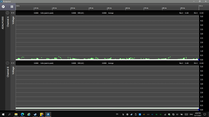

Because you must realize, that the power output of the two-prong power adapters are "floating", i.e., the GND pin they have are not grounded.
This is because the AC 110V are supplied on both pins (think pin1 is -55V and pin2 is 55V), and because the two-prong do not have access to the ground pin (on a three prong), their power output for "ground" is floating.
On the desktop computer, however, the power plug is three-prong and therefore all the "GND" on the computer is connected to ground. It will be properly grounded.
And because you have one 12V powering the RFID and one 5V powering the Arduino UNO, none of their "ground" plane is actually connected together.
Here, I have a ADALM1K (USB oscilloscope). I will show you in a moment ...
This is when channel A is connected to my Apple USB power adapter (three prong, grounded)

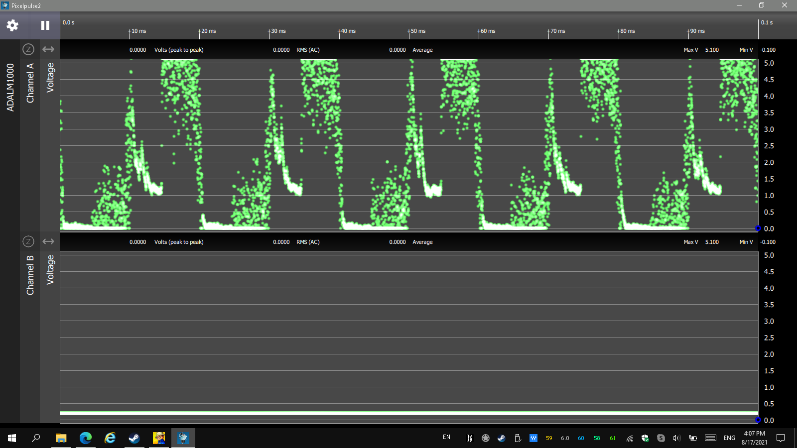

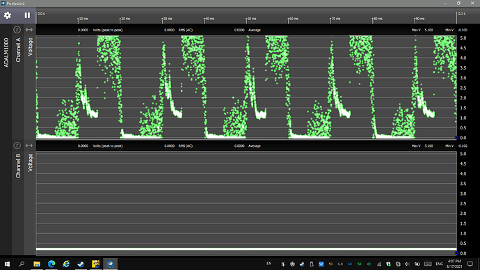

And THIS is when channel A is connected to a USB power adapter without ground:
(notice, in both occasions, "channel B" is left floating, at about 0.2V.

As you can see the difference is incredibly big, and this is why you should have most things grounded via a three-prong plug.
This is why you had it working when you plug it into your PC. Because this way the PC grounds the Arduino, providing a clean 5V and allowing it to provide a clean signal. Even though the rest of the apparatus is floating, the servo worked fine. Perhaps because internal circuitry (in the servo, but likely the RFID) helped grounded them.
