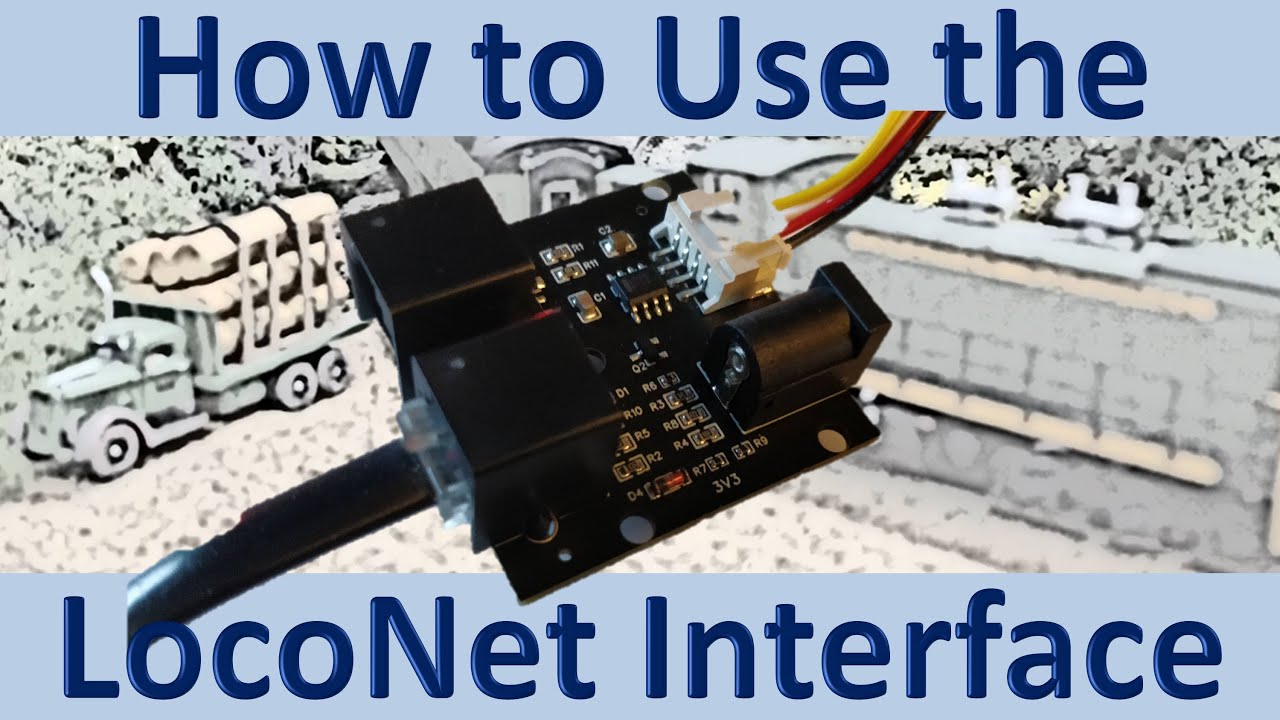

Not a very expensive breakout board, so was nice to get something prebuilt.
The maker of the board did a video of a simple usage.
Regarding the voltage, he says that the board was designed to work with 3.3V but that his experience is that it has worked with all 5V Uno and Nano processors.
There is one library modification that we needed to make which he goes over in the video which is the uncommenting of the library definitions for LN_SW_UART_RX_INVERTED and LN_SW_UART_TX_INVERTED.

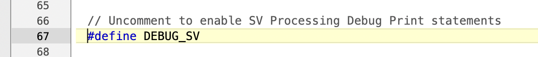

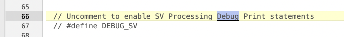

I want you to edit your libraries copy (it's local to you, no concerns, just do NOT allow any auto updates) to enable DEBUG. In your libraries/LocoNet/LocoNet.cpp make the following change, from this
to this
Screenshot 2025-02-11 at 13.38.15
that will help a lot, but if not conclusive there is also the following
from
to
If we can't figure it out after that, then I am probably stumped.
Have a go at looking at the serial output to see if it's obvious but if not, post everything you have in the serial log to a reply so I can look.
