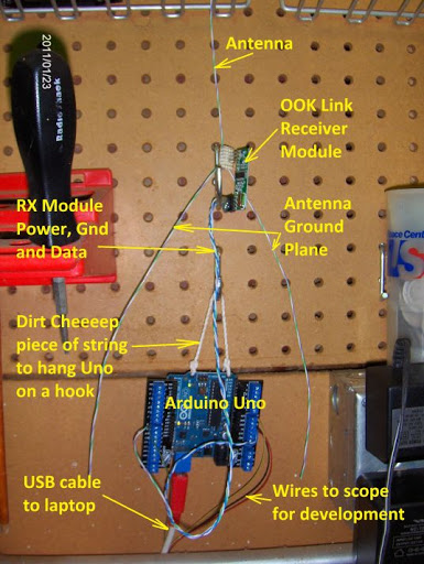

Here is the master station
When DCDW development is finished, only the l33t beta testers will have the genuine DCDW master station official mounting string. Compatible with all genuine Arduino boards. Cost is just one carton of Samuel Adams for the development team! Supplies are limited, Sign up today!

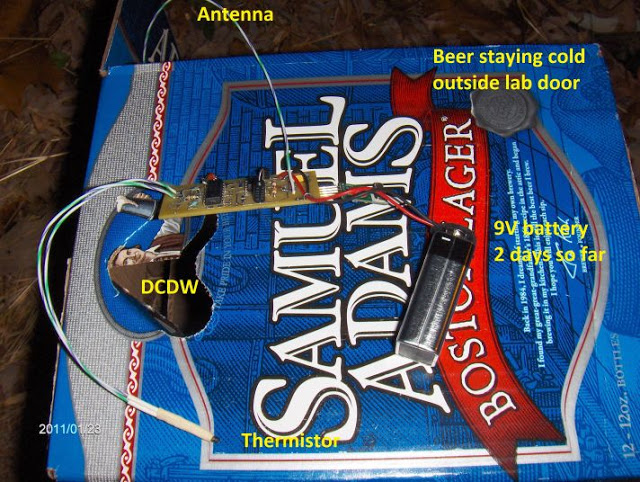

Here is the indoor temperature sensor node
Here is the outdoor temperature sensor node

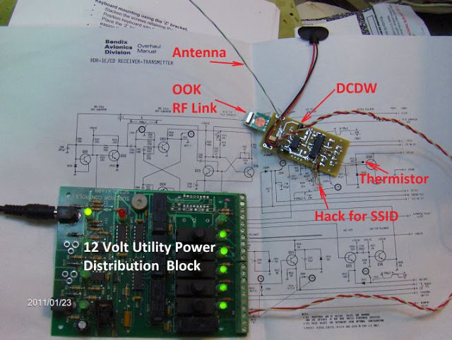

PCB layout v0.01 requires the ugly hack to scab on a diode, resistor and capacitor to put the DCDW in SSID mode. This will be cleanly accommodated on all PCB versions going forward.

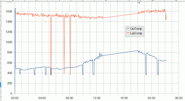

Here is a Open Office import of what the DCDW master received from its nodes
Long straight lines are missing data when WinDoze7 ( >:(DONT get me STARTED >:( ) despite all power profile settings fell asleep and stopped listening to Arduino Uno.
Time is Arduino millis(), we have no Real Time Clock as you would use in a proper data logging project. We also have made no effort yet to convert frequency (Y axis) backto temperature. This is only a proof-of-concept for DCDW with one master node monitoring a swarm of sensors on a single channel.
The collisions are evident. Most falsely accepted collisions the outdoor node was sending its ID and was interrupted by (much stronger) indoor node ID which was erroneously accepted as the data for the outdoor temperature. Better spaghetti code software will fix this. You software mugs will get a laugh out of this:
