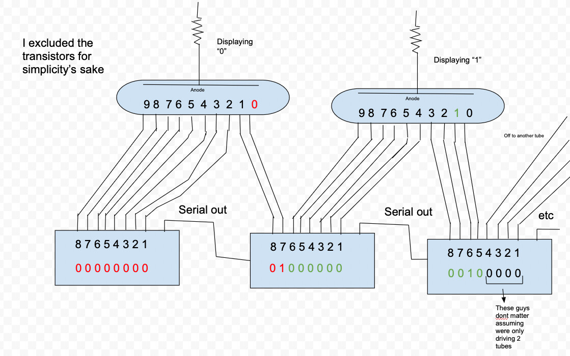

This might be a long post. I already have some experience using 74HC595 SIPO shift register with stuff like 7 segment displays which is nice and easy since you only need to deal with 8 bits, which is the same # of outputs on the IC. I've also used them to drive Nixie tubes with the k155id1 nixie driver, which required 4 bits input and decodes a one of ten (0-9) decimal value on the Nixie.
So, I wanted to try driving nixies with only shift registers, instead using MPSA42 transistors to deal with the high voltage stuff. I would connect it like so:
0000000001 -> digit 0
0000000010 -> digit 1... etc (one of ten fashion)
Since the number of bits is greater than the # of outputs on the IC, I decided that I would divide it by 8's, sorta. Like this:
00000000 - 01000000 -- 0010XXXX (we don't care about the last 4 remainder bits for now)
so the first 10 bits are connected to the first tube, the next 10 are connected to the next, etc.
if we look every 10 bits (ignoring those 4 remainders) we get:
0000000001 --> 0000000010 which is the correct sequence of digits to display.
I realized that each register would kinda follow this pattern:
first register is just the first 8 bits of the first digit (from left to right), so I used a bit shift for this.
second register is the last 2 bits of the first digit followed by the first 6 digits of the second digit. (achieved this with a bit shift along with a bitwise OR)
the third is would be the last 4 bits of the second digit followed by the first 4 of the the next digit. (I didn't specify the third digit yet, so its just "0bXXXXXXXXXX" for now.)
I then continued this logic for the other registers, but I'm keeping it to 3 in this for brevity.
As for the code, it works completely as intended (unless there's some unique test case im missing but I doubt that) , but I'm just wondering if I overlooked a simpler way to do this:

And here's a simplified version of the schematic:
So yeah, my method works and all, but I'm just wondering if I made it more complicated than it has to be?
Thanks.
I would say not. If you want to use shift registers this is how to do it.
I am assuming that you have the shift register clocks common, and you have but a ceramic decoupling capacitor (0.1uF) across power and ground of each shift register.
Ah I figured. Thanks a lot for your input. yes, I do have the clocks common, as well as the decoupling caps.
You could make it a little simpler to code by using two full shift registers (16 output pins) for each tube. Only you can decide if the savings in hardware (5 registers for 4 tubes instead of 8 registers for 4 tubes) is worth the additional complexity.

I see. That's a good solution. I like the idea of having an extra register to hold the 2 most significant bits.
Unless I misunderstood you, my code has 8 registers for 6 tubes though. Regardless, I get your point.

Did you think of the voltage on the nixie segments when 'off'.
The 74HC595 can't have more than VCC+0.5volt on it's outputs.
Maybe try TPIC6B595 chip, which have a 50volt rating.
Leo..
well that's why the mpsa42's are there
I suppose that you could make the code simpler if you use you own version of shiftOut() which pushes 10 bits out at a time to the shift register chain instead of 8. Then You'd do something like:
shiftOutNew( secondsLow) ;
shiftOutNew( secondsHigh) ;
shiftOutNew( minutesLow) ;
Etc.
At the end you'd have have to push through 4 bits to make up the full 64 bits.
You could use the remaining 4 bits to control the digit separator neons.
There are other option like pairing the tubes and have each pair driven by 3 shift registers. That would make the design more modular at the cost of an additional shift register.
You can use TPIC6B595 shift registers, as already suggested, because these have 50 volt clamp diodes allowing you to drive (sink) the tubes directly (say 170volt on, 120volt off). However, if you want to display a blank digit (say for scrolling) then you need to switch the anode off to achieve that. I have made such a Nixie clock using these chips.
ah, this didn't occur to me. I think I'll implement this. thanks!
By using the fact that the high hours digit displays only a 0, 1, or 2, you could also reduce the hardware. However, it prevents that tube being fully incorporated in an anti cathode poisoning cycle.
I considered this at first, but I wanted to have it display stuff other than the time, not to mention the cathode poisoning issue.
I suppose I'll implement my own shiftout and use the TPIC. I've also seen SPI use for this type of shift register purposes iirc. I'll check it out some more I guess. Thanks again.
