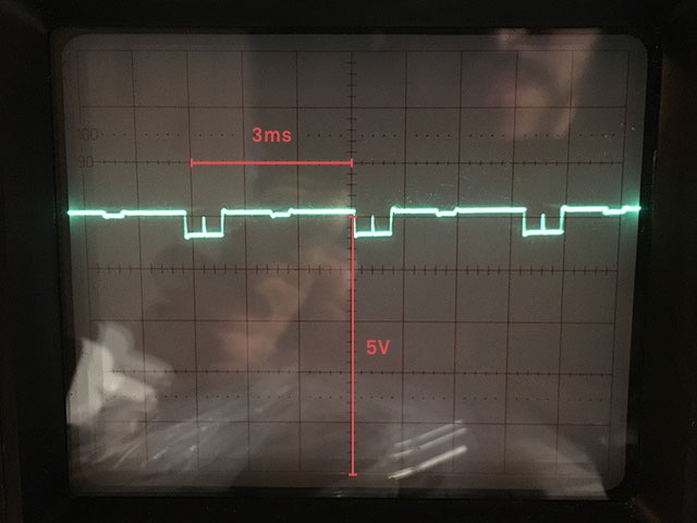

Hello,
I've got the following circuit:
Arduino Micro
2x HT16K33 led drivers (on adafruit breakout, connected to I2C)
4x analog sensors connected to the analog inputs with a 100uF and 1uF in parallel in front of them (as suggested in the datasheet of the sensors)
Everything is working like it is supposed to, but since connecting the led drivers there is a lot of noise on the reading of the analog inputs.
I connected a scope and noticed it's the 5V power supply coming from the Arduino that now has a regular noise on it (see attachment).
It starts with almost a 0.5V drop and then in the middle of that cycle again a noticable drop of 0.1V?
Maybe I should mention the current 100uF / 1uF combination is only used 1 time in front of the first sensor, the power and grounds are then parallel wired from there on to the following 3 sensors.
I suppose this is solvable by using the right capacitors in the circuit?
Is there a formula to calculate the values for the capacitors, based on the noise you see on the scope?
Looks like you don't have a star-ground setup. How much current do you LEDs take?

There aren't many leds connected or activated at the time of measuring:
  • led driver 1 draws 60mA
  • led driver 2 less than 10mA
  • current going to the sensors is 10mA
What does star-ground setup mean? All components having their separate ground-wire or -line?
The 2 led drivers are wired separate to the - and + lines of a breadboard, the sensors are on a seperate printboard which is wired to the breadboard's lines.

Ok, I think I'm starting to understand what's going on by disconnecting all the leds.
I was using 2 cathodes of led driver #1 (connected to 2 x 8 leds / anodes) and 1 cathode of led driver #2 with only 1 anode / led active.
The first drop in voltage are actually the 2 cathodes of led driver #1 which had an equal amount of leds active, so these are 2 drops, you can see a little spike going up between those 2. The second (third) smaller drop is the second led driver which drops a tiny bit because only 1 led was active there.
Putting resistors before the leds would make the distortion smaller but doesn't solve the problem (and the leds would be too dim because they are actually never fully "on").
I guess the real solution would be to separate the supply voltage / grounds between the analog and digital circuit? I guess that's not that simple? Any advice, tips or relevant threads are welcome... I'll do some google-ing.
BUT
I was thinking of an alternative solution, what if I connect the 5V directly to a fifth analogRead() and use this as a denominator to compare the other analogReads to? So if we're at the 4.5V part in time the analogReads are scaled against this? Probably a long shot considering timing between analogReads and the lineair scalability of the sensors at lower voltages...

That adds up to 80 mA. Add another 15-ish for the Micro itself (believe it's based on the Leonardo, so it's an ATmega32U4) and you're pushing the limit of USB's default current output. I doubt the Leonardo bootloader negotiates for the extra current, so you're probably stuck with 100 mA running off of a computer's port.
Add to that the fact that the integrating ADC in your multimeter is going to average out the current spikes going to the multiplexer chip, and it's clear you're overloading the USB power. Star grounding won't help that. Larger capacitors might, but it's not guaranteed.
The solution is to make the analog portion less susceptible to power supply fluctuations. Instead of using the default analog reference, use the internal 2.56V one. It's pretty bad by voltage reference standards, but a huge improvement over referencing the supply voltage. If the sensors are also sensitive to changes in supply voltage, you could run them off the 3.3V supply instead of 5V.
The drop you see is probably mainly from the onboard polyfuse in the USB supply line.
0.5volt is ok for digital circuits, but it could indeed upset (non-ratiometric) analogue reads.
You didn't say what sensors.
Maybe you could read them with 1.1volt Aref (I don't think a Micro has 2.56volt Aref).
The idea you had about reading VCC and using it to compensate can also be done in software.
