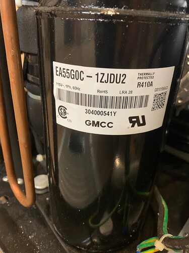

I got it going…. It’s defiantly producing water and bringing the humidity down. I can’t find any information or data sheet on the compressor. I still need to tweak code some, but now I have another concern.

Label on compressor.

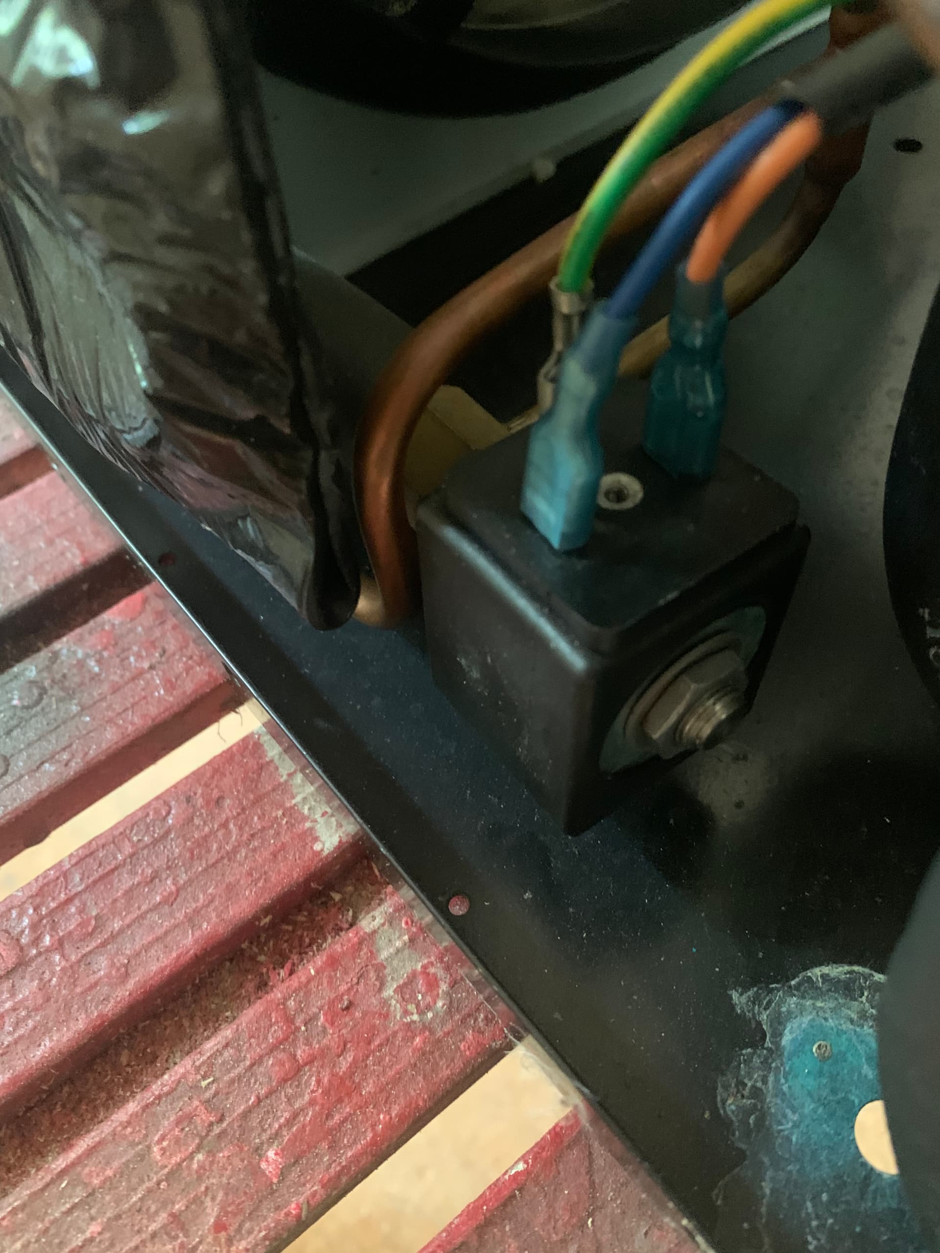

And what I am assuming is the expansion valve:
Edit: I also found that it was a Parker zb09 solenoid valve.
Information on it:
https://ph.parker.com/us/en/parker-2-way-normally-closed-1-4-general-purpose-solenoid-valves/pm126yh-zb09-230-50-60
Need to know what it connects to.
But it might be an equalizer valve that allows the refiferant to equalize.
Reducing the risk of high pressure starts
What do you mean what it connects to? Electronically? Or how it connects to the closed system? Copper lines?
Thanks!
The electrics look pretty obvious. I suspect that @dave-in-nj has identified what it does, where do the copper lines go?
Given that my experience with equalizer valves goes back to oh, about 1pm, I don't know how to figure out when you should apply power to it. Maybe there's a pressure sensor somewhere. Maybe it should be activated when the compressor's running. I'm unsure how you can find out.
Yes. What pipes is it connected to.
I suspect between the compressor discharge before the expansion valve.
To the low side.
There are two tubes on going in to the valve/solenoid. One comes from compressor. Other goes to I what I guess would be the coils that sweat to produce the water. It is covered up with insulation and can’t tell exactly where it’s going. Here is a video to show a little more maybe:
I know the video is not very good, but the solenoid/valve is connected on one side from the discharge side of the compressor. It is not insulated and is warm to touch when running.
The other line connected to the solenoid/valve is insulated and goes toward the coil. It’s hard to tell exactly where it’s doing because it is insulated.

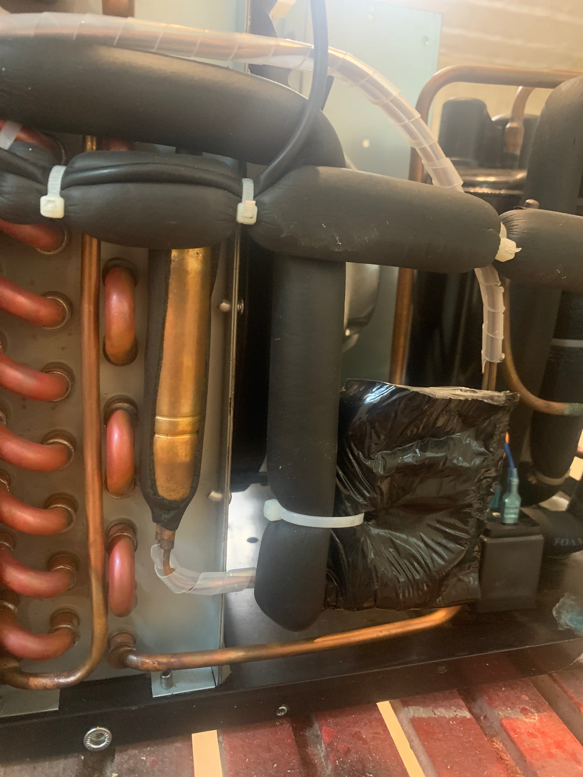

Then there is this:
This copper cylinder thing (capillary tube?) has two small copper lines running out the bottom. And one large line coming out of the top.
The two small lines run to whatever is wrapped in insulation (black square insulation in picture and has the zip around it). And then two copper lines come out of that same black square insulated device at the top and run to the coil.
The large line at top of what I am calling capillary tube is going to the coil at the bottom. You can see where it connects at the bottom left of the picture.
Is whatever is inside of that square black insulation the expansion valve?

@dave-in-nj
I have been doing some research on pressure equalizer valves and found this:
Pressure Equalizer Valve (PEV)
At the end of every compressor operation (after the 3.5 minute
Time Guard period), the equalizer valve opens for 150 seconds
plus an additional 15 seconds of protection before allowing the
compressor to start ramping up.
The PEV is located next to the suction and discharge of the
compressor. The function of this valve is to prevent the
compressor from starting with a high refrigerant pressure
differential, thus helping the reliability of the compressor.
NOTE: A hissing sound may be heard during the equalization
process. This is normal.
This seems to be fairly simple to add. I would just need a third relay and set it up to turn on when the compressor cuts off for a certain amount of time.
Do you think a pressure equalizer valve is what I am dealing with here?
Thanks!
The solenoid does sound like what you posted.
Easy enough to add the extra relay.
Seems like you are close to replacing the original board.
I half expect that when you go to reassemble the full original schematic will fall out
This is the short "Pfffft!" sound you commonly hear as the compressor turns off. :grin:
Thanks!!!!
So, if I get a third SSR (30 amp max prob over kill?) like I have for compressor and fan, and connect it to arduino. I will just have it set to energize (open?) every time the compressor turns off (stay open for 3 minutes?).
When the equalizer valve opens, this allows the compressed air time to release back in to the low pressure side of they system before the compressor kicks back on while under pressure?
Am I understanding it correctly?
