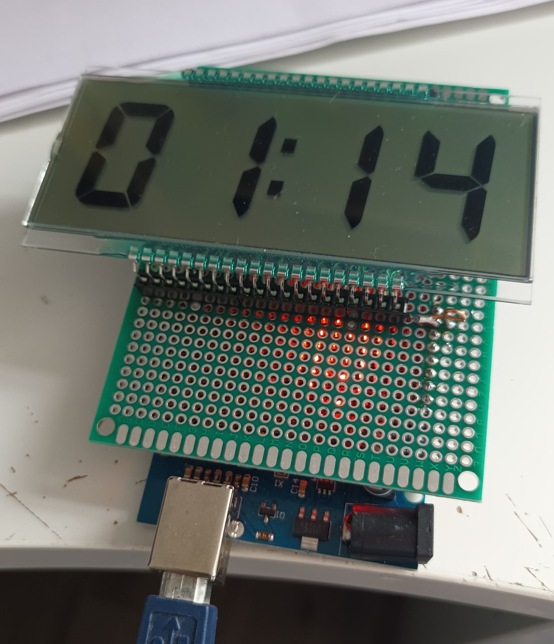

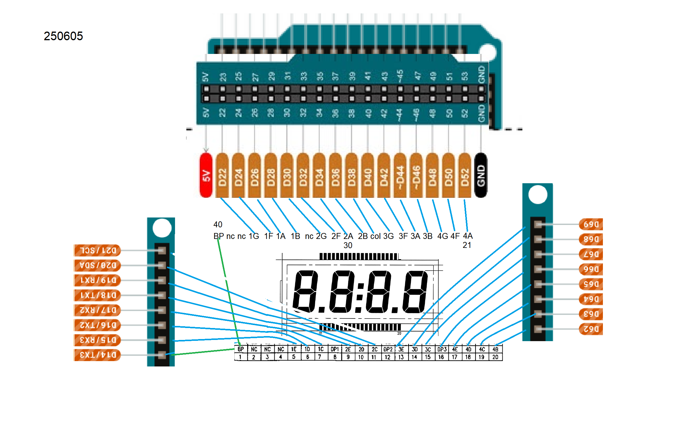

Hi, I also have had a lot of fun making a 4-digit 7-segment LCD work. In a previous post on LCDs, there is a link to a Youtube video, where this Australian guy explains the basics. Next stop was Rachel de Barras' piece on interrupts, which included a neat trick for toggling an output. I used a Mega to get enough I/O for the display, so no need of any other components (some of the 31 wires were less than 1cm, with 12 of them 1-to-1with the Mega).
Will post the rest after lunch!
Using a variable for the I/O saves lines of code!

Each digit has its own array of outputs for each character to display:

When writing to the LCD, I first clear it, send the data to display, then set the BP pin LOW.
void lcd_1(void) {  //0-9, 10 = u, 11 = d
  for (c = 0; c < 7; c++)
    if (lcd1[lcd_digit][c] > 0) digitalWrite(lcd1[lcd_digit][c], HIGH);
  digitalWrite(14, LOW);  //BP
Easy when you know how!
