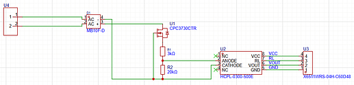

i use this circuit to detect AC 220v signal in esp8266 module
so there are 2 PINS **i\_1 (phase)** and **N(neutral)** and if i connect AC there then i recieve GPIO\_HIGH on esp32.
this is ok till here.
what i want is a way that i can use same pin with 5v DC so a way that i can connect 5v+ to N or i\_1 pin and ill recieve GPIO\_high on esp32
so i can use either AC or DC5v on same pins (N, i\_1)

To clarify: you want to modify the circuit so you can monitor AC or DC @5V and 220VAC from the same input?

Your 5 volts must be able to light ONE of the leds in the opto. So, limit the current on the 5 volt line to what is necessary.

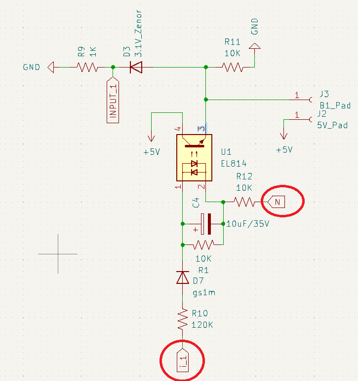

> [@Paul\_KD7HB](#):
the question is how can i connect to **terminal i\_1** or **terminal N** the 5v . what should i do in circuit so i can connect 5v but also if i connect ac it will work like it works now

With R10 (120k) and R12 (10k) there won't be enough forward current to turn one of U1's LEDs/IREDs on.

Further to what @anon85221860 said, even if there was enough current to light the LED, their is no ground. Connect 5VDC to L1 and there is no ground for the LED; or connect 5VDC to N and signal to L1 is blocked by D7.

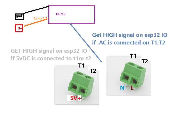

I'm not quite following you here:
1. Do you wanna switch between reading 220V or 5V, or
2. read with one pin the state of NONE / 220 / 5 / 220+5 ?

![Untitled](https://europe1.discourse-cdn.com/arduino/original/4X/c/1/b/c1b7b5e80d7d911666522a081cc4ec627296c7b3.png)
let say i have one 5.08mm2P terminal . so i can choose to connect AC there or connect a wire from 5vdc there. and i will get HIGH signal on esp in booth cases
so 2 different scenarios and i can either connect AC or DC to get signal on esp

I don't consider that as practical purpose.
Get two terminals, two circuits, twenty cents.

i can use 2P2T slide switch also. but question is if this can be done wihtout using switch.
its not that i will do this but its a question so me and others can see if this can be done
