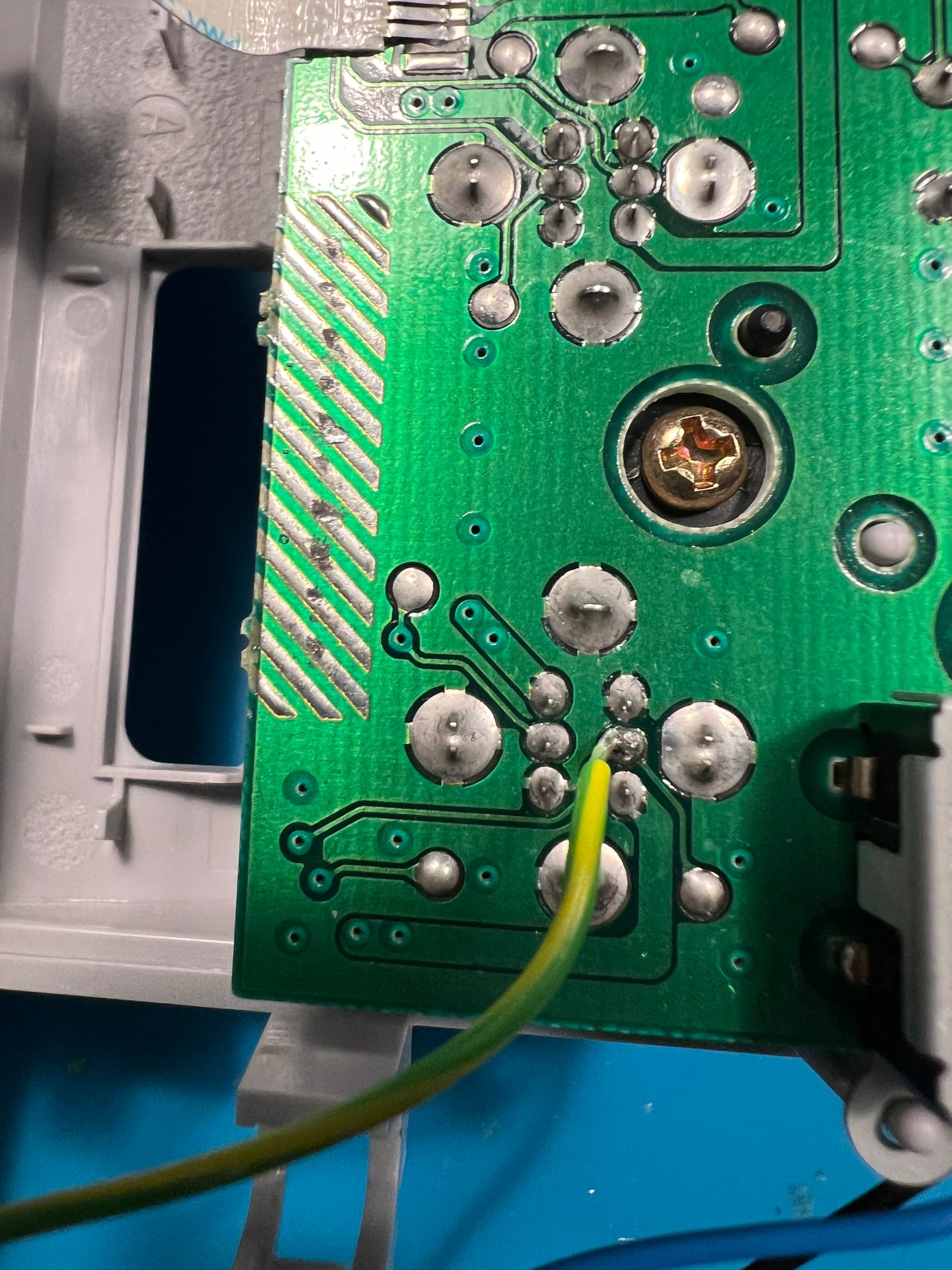

Thought of a ‘stupid’ solution. I removed solder from one of the internal ground pins and connected the pin from the connector to a pin of my arduino. When the controller plugs in the shielding completes the circuit.

Hi @Railroader!
I’ve attached a picture. Just a wire connected to an analog pin. When the controller is connected the metal shielding of the controller plug connects everything to ground.
 ![IMG_9406](https://europe1.discourse-cdn.com/arduino/original/4X/6/e/0/6e048ee333a6260cb1002f587d8a9b3316e826af.jpeg)
I removed the solder from the pad so this isn’t connected when nothing is plugged in.

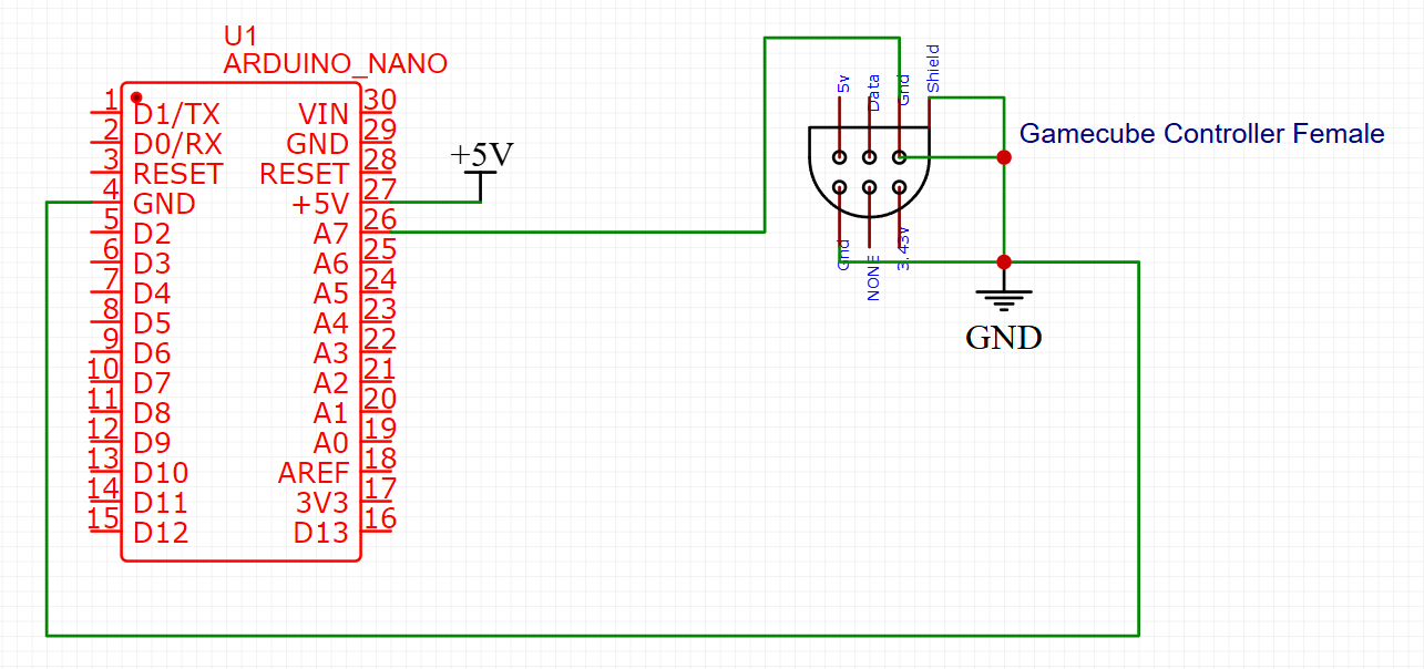

Here you go:
 ![Schermafbeelding 2025-07-18 020601](https://europe1.discourse-cdn.com/arduino/original/4X/d/3/6/d3668f363bbe97084390923c36eb1c4f9f789de4.png)
Nothing done to any of the other connections. Just solder removed from GND pin 3.
So A7, pin 3 on the controller port and ground aren't actually connected until the controller is plugged in.
Can you let me know if this simple solution can cause any harm to the electronics? I dont think so, because it's all connected to ground one way or another. With or without GND pin 3 connected by solder.

That seems like a pretty legit solution to me- simple and does what you want! My guess is if the arudino and gamecube share the same ground it should be ok
