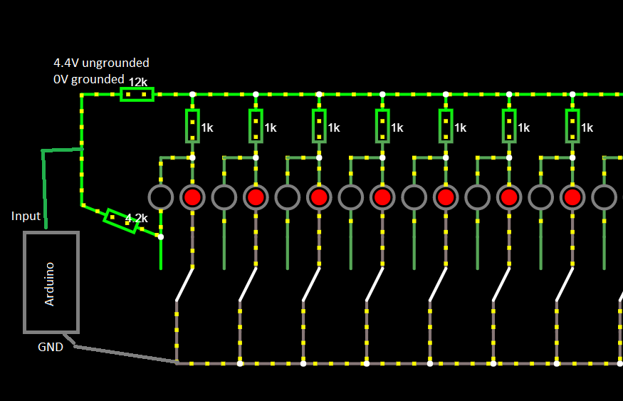

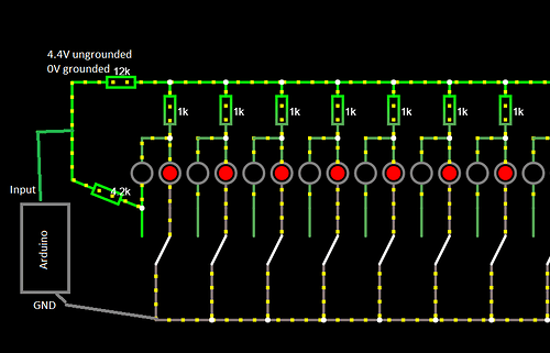

I do apologize for my lack of knowledge but I tried decoding what you meant in your previous post. Are you talking about bypassing the 1k resistors. and then have a voltage divider (ex 12k R1 and 4.2K R2 but connected to the 17V) and see if it is grounded? And how do I connect the ground of the Arduino? Do I connect arduino ground to the ground of the transformator?
This is what I understood.
Whatever is practical, whatever point you can easily solder an additional wire to.
If you tap it from right at the leads of the LED, you have the 1k resistor as part of your voltage divider network, adjust R1 accordingly.
Yes.
Alternative way of detecting the switch would be to hook up to the switch itself like this:
Use the built-in resistor to pull the pin HIGH when the switch is open. The switch shorts it to GND pulling it low. The diode D3 prevents the high voltage (in my schematic 15V as I don't have a 17V symbol ready made) to flow into the pin of the Arduino. Connect Arduino GND to voltage supply GND (or the other end of the switch, which should be the same.

Huh? I need to connect the arduino GND (any of them? (mega2560) to my 17v power supply GND to make this work?
How could you expect to detect anything without doing that?

Thanks everyone! I was able to get a signal into the system now! I think the common ground was the main problem.
wvmarle, thanks very much for the ideas, unfortunately I do not have LED's laying around. As I live far away from civilisation I only 270, 330, 4k2 and 12k ohm resistors. Now I just use stepdown from 17 V and ground the step down via the switch. That way I get 3.3 volt ungrounded and 0V grounded.
