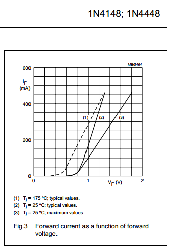

I just took one diode datasheet out there and it seems there is a relation between forward current and forward voltage... I even picked a simulator (not a spice one) and checked it and by raising and reducing the current I actually get a different voltage drop....
Are you sure there's no relation between the two? Am I reading the datasheet and the simulator wrongly? Can you explain?
You can think of a diode as being a "one way valve" or "check valve" for the current. It takes a bit of pressure (i.e. voltage) to open the valve. This is the forward voltage drop.
I was trying to keep it simple for you. To a first approximation once a diode is conducting that is it forward voltage. In practice there is a slight increase as the current increases but this is totally irrelevant for what we are talking about. It can never reach the 3V3 needed to register as a logic one.
