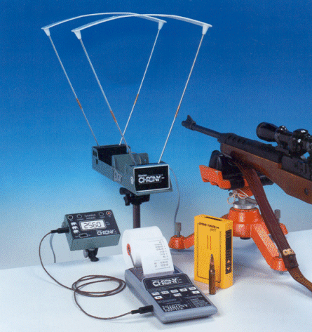

How fast is the approaching object moving? bullet speed?

allanhurst:
