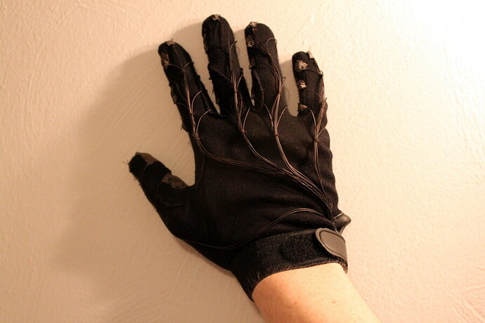

I've been working on developing a "keyglove" prototype as a personal experiment, and I decided to use an Arduino board for the hardware end of things since it seems like a perfect tool. I don't have the board yet, so I can't test anything, but I've been working on the source code and I've run into a conceptual problem.
Basically, the keyglove has 25 sensors on it which are electrically nothing more than wires that go nowhere. They aren't buttons, just conductive pads. I have come up with a design that works in principle by detecting which sensors are touched together. This approach allows a whole lot of possibilities without being ergonomically difficult.
My problem is this: it doesn't seem possible to detect simply which digital pins are connected together. It might be a terrible idea to short them under any circumstances, I'm not sure. I know you aren't supposed to short two pins in output mode together at least.

For more info on my idea and approach, read the post from 9/28 on sectorfej.net (I would post a proper link, but it won't let me since this is my first post). That post also has an image of my glove sensor arrangement.
As a follow up, since the board should let me now, here is a proper link to the above mentioned blog post, and the glove sensor arrangement image:
As above, you are on the right track. One property of the microcontroller you can use is the existence of pullup resistors. An input will be high (with pullup enabled) until forcibly driven low. So the easiest approach (I think) is:
Setup: enable all pins as inputs with pullups
  1. Set Pin 1 as an output and drive it LOW
  2. See which other pins are now LOW -- they are connected to Pin 1
  3. Return Pin 1 to be an input with pullup.
  4. Set Pin 2 as an output and drive it LOW
  5. See which other pins are now LOW -- they are connected to Pin 2
    etc.

Thanks to both of you for your help! The loop implementation works great. I'm well on my way to getting this thing off the ground. I've made some design changes since my last post (mainly a few more sensors), and it looks like it could be an excellent device once the rest of the hardware I'm waiting on shows up.
